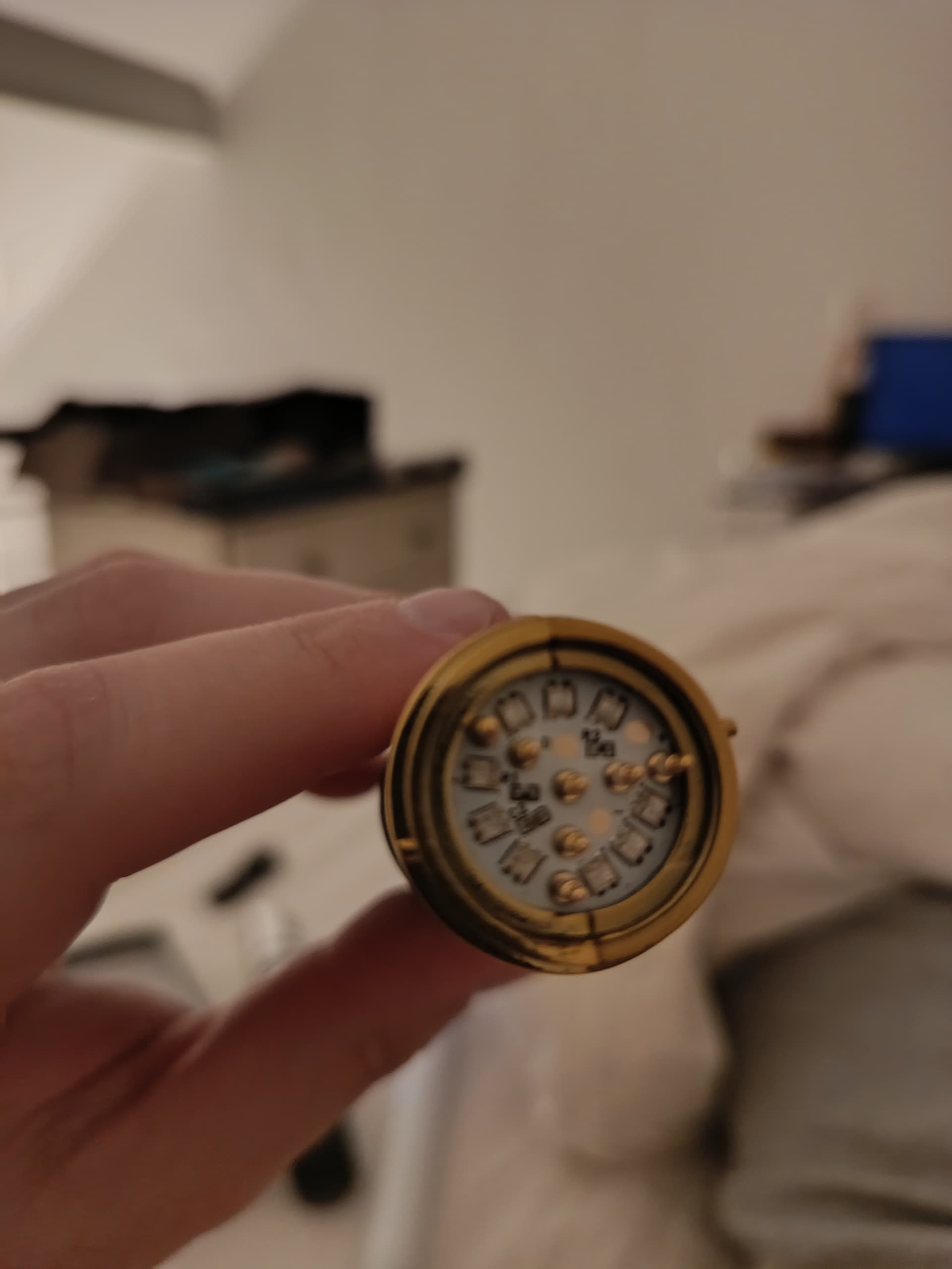

I was a big dumb dumb and connected my existing pixel blade to my new proffie-based core, and I can only suspect that it’s blown one of the 1st LEDs in the blade because it’s not lighting up past maybe 5% of the whole blades length. It’s because I forgot to notice that the connector pin layout is different on the proffie Vs my SNV4 code… I know - I’m an idiot.
I can’t seem to find a replacement blade compatible with the specific pin layout (see pic) - any ideas where I can get one? Thanks so much.
Nothing special there. Standard 3 ring blade PCB configuration.
Data center. Negative mid ring. Positive outer ring.
Why do you suspect it to be different?
Hey! Really? It’s just in insane coincidence then when I tried the new chassis/core that it seemingly caused the issue with the blade?
Is it possible that the pins just didn’t quite line up and caused a short or something?
If not, then “insane coincidence” may be the answer.
That sounds likely. :melting_face:
I guess I’ll try open up the blade and either bypass the blown LED or try replace it.
So just for further clarification - would other pixel blades work? I will likely try and just get a spare blade anyways. Would like a tri/quad strip setup but holy hell they are pricey.
As far as I know, all blades (of the right diameter) should work.
It is possible that someone wires up something differently, or use a different distance between pins, which would make blades incompatible, but I’m not aware of anybody doing that.
I usually make my own blades though, so I don’t have a lot of information about what people are actually doing out there…
