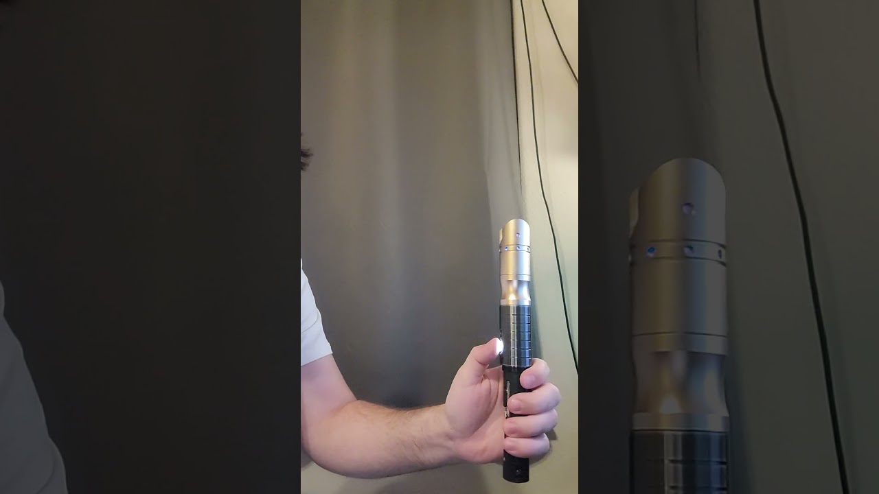

Hey guys, just got my first proffie saber and spent the night last night configuring and testing and configuring some more. Everything went well for the most part after some initial first-time use issues, however, now I can’t seem to reliably get into the volume menu, and the control list that the config helper gives me does not seem to be accurate.
These are the controls I’m having trouble with. I am trying to enter the volume menu but when I hold and clash, it just plays quotes. I got it to work one time randomly out of probably 100 (my hand hurts from clashing…
), and I believe I’m doing it right as I did it without a problem both with the original config as well as the new config from fett263.
The problem arose a while after I had pretty much switched gears from working on config settings to just fine-tuning and adding styles and fonts. The clash seems to work fine otherwise, and the quote doesn’t play from just button pressing, it is confirmed to play only on Hold pwr + clash. I’m also wondering how it works that gesture turn-off and volume menu have the same control.
I’m not sure if this will help or be an additional indicator of a larger problem, but I can no longer get the battery level command to work either. When I execute the command, it gives me a quick flash on the button and then nothing, almost as if it doesn’t have anything to pull from. I got a similar response earlier in my config-building work last night when I attempted to play a default track on a font that I had created a custom track (incorrectly) for and thus didn’t have anything valid to use for the command.
I debugged and researched last night and for the last few hours this morning to make sure I wasn’t asking an existing question but I’m really at a loss here and, again, my hand is in a bit of pain at this point lol. Any help would be greatly appreciated! I’ll attach my current config below with most of my in-use presets. It’s probably more than you need, but want to be thorough.
