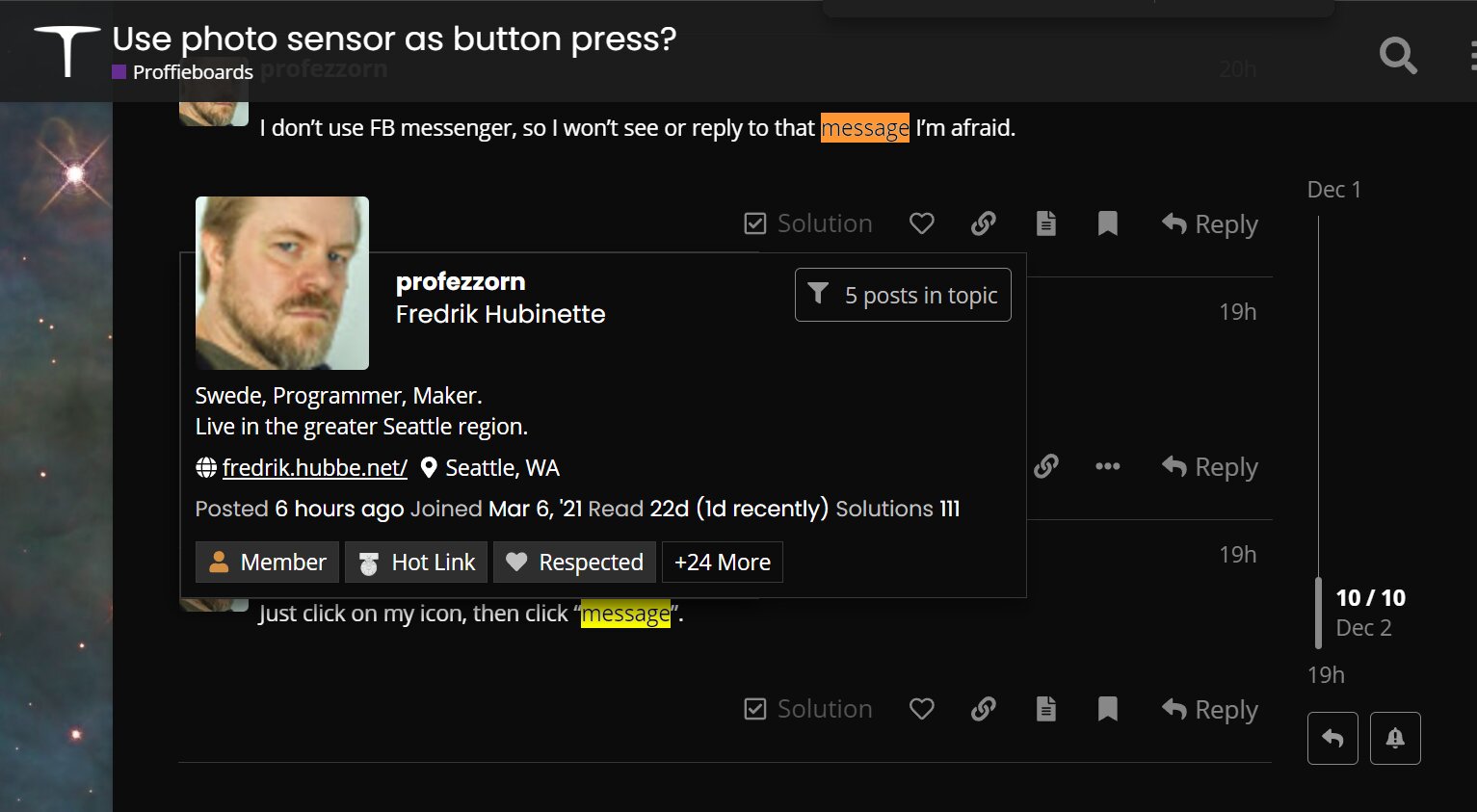

Just click on my icon, then click “message”.
Weird, this is all I see:
Ok, so this turns out to be a “new user” restriction.
In general, the “new user” restrictions goes away after reading the board for a little bit. These restrictions are intended to discourage people from creating spam accounts in order to post links, spam users with messages or other weird stuff.
