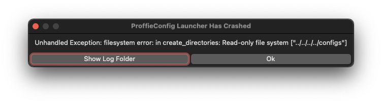

Ok so i deleted all things ProffieConfig that I had, and downloaded ProffieConfigLauncher-macOS.dmg.
Mounted the diskimage, and put ProffieConfig in Applications directory.
Double clicked it, got the stupid Apple Gatekeeper “you can’t run this blablabla”.
System settings>Security&Privacy, let ProffieConfig open anyway.
Enter password.
It launches, then this popup:
Was I not supposed to get rid of all the base system stuff, as this is just a new launcher?
Sorry if I didn’t read the whole history leading up to this release.
You can purge everything (AppCleaner does a good job of this btw) if you’d like, and it won’t matter.
You actually don’t even need to open move it to the applications directory. ProffieConfig will install itself into the Applications folder automatically.
Someone brought that error up to me, it was my fault in the way I had set things up.
There’s a new launcher on there now that someone else was able to test doesn’t have those issues, and I was also able to fix a few issues they found.
TL;DR I’ve fixed this now and you should be able to get through to test the actual application.
I’ve now also dropped the minimum supported macOS version down to Big Sur. (The minimum version the code actually needs rather than the arbitrary default derived from my dev system version).

[Arduino::cli()] (DBUG) Executing command ""/Volumes/bconnerX/bconner/Library/Application Support/ProffieConfig/bin/arduino-cli" board list 2>&1"
[Crash Handler]  (ERR) Segmentation fault: 11 at address: 0x406746e7f
ok. Tried again and this time there was a Compile Error popup when uploading:
There was an error while compiling:
Unknown error: Error: accepts at most 1 arg(s), received 2
Usage:
arduino-cli compile [flags]
Examples:
/Volumes/bconnerX/bconner/Library/Application Support/ProffieConfig/bin/arduino-cli compile -b arduino:avr:uno /home/user/Arduino/MySketch
/Volumes/bconnerX/bconner/Library/Application Support/ProffieConfig/bin/arduino-cli compile -b arduino:avr:uno --build-property "build.extra_flags=\"-DMY_DEFINE=\"hello world\"\"" /home/user/Arduino/MySketch
/Volumes/bconnerX/bconner/Library/Application Support/ProffieConfig/bin/arduino-cli compile -b arduino:avr:uno --build-property "build.extra_flags=-DPIN=2 \"-DMY_DEFINE=\"hello world\"\"" /home/user/Arduino/MySketch
/Volumes/bconnerX/bconner/Library/Application Support/ProffieConfig/bin/arduino-cli compile -b arduino:avr:uno --build-property build.extra_flags=-DPIN=2 --build-property "compiler.cpp.extra_flags=\"-DSSID=\"hello world\"\"" /home/user/Arduino/MySketch
followed by a bunch of usage instructions for flags.
There’s no way to scroll down or to close the popup window. It is not resizeable, and continues down below the bottom of my screen.
Needed to force quit the application.
That’s macOS doing macOS things w/ the app bundle.
Yeah it installs stuff into its ProffieConfig folder there.
/Applications requires admin privileges to modify, which makes it unsuitable for what the launcher needs to do, that’s why it uses ~/Applications instead.
On macOS things are different enough I could probably make this not the case, but whenever I was setting things up (at this point probably close to a year ago), it just made more sense to do it that way.
It shouldn’t cause any usability differences? (Spotlight for example still indexes that folder)
Theoretically that shouldn’t cause any problems.
Yeah, certain crashes are just completely unrecoverable and ProffieConfig can’t display the “Crashed” message box, it seems like that’s what’s happened here.
That’s an oversight in the macOS dialog I used. I can look into truncating it and spitting it out elsewhere if things get too long in the future.
I saw something similar on Windows. I updated to the new arduino-cli and it seems to have changed some things. I suspect that it’s a similar issue to what Sabersense had where me dropping the macOS API has caused a breaking change that I missed, since I had fixed what I saw originally, but I’ll take a look.
I’ll get back to you if I’m able to recreate and fix it, thank you for letting me know.
