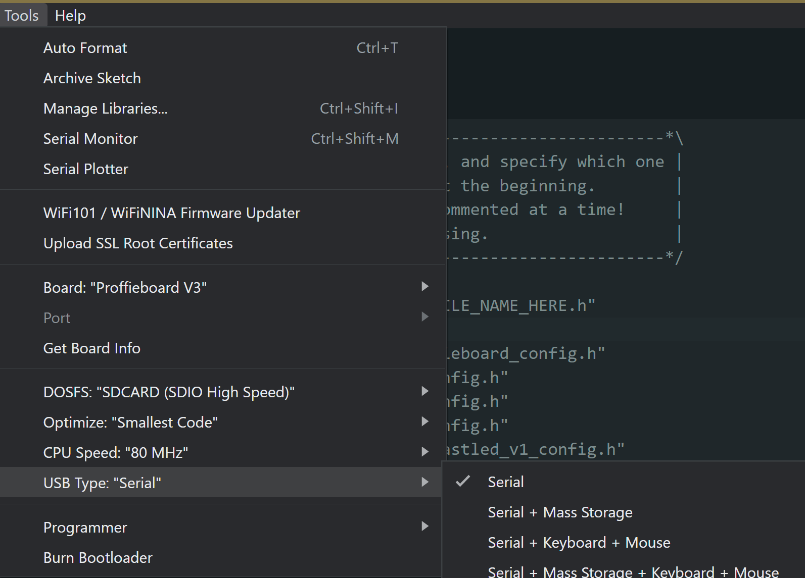

I hooked up and checked serial monitor and did see some Audio underflow events.
However, once I was checking serial monitor (this is the first time doing so with this board) I noticed that serial monitor would start normal and show event/logs and respond to “on” “clash” etc. but then it will stop reporting completely.
  • Board will go to disconnected state within Arduino.
  • Saber is still on and acts normal to buttons etc.
  • Will have to reconnect board by selecting com port again.
  • SD is in during all of this and once I reconnect, the browse SD card will reopen after a few seconds.
  • I have tried different cables, same result.
  • I have changed my config to removing all Fett options and his prop and just having a bare bones config with basic controls and still the audio glitches occur along with the serial monitor disconnects.
  • I have no disconnects or issues when uploading configs.
  • I am using 7.8 currently.
  • I will try to get serial logs to post.

What do you mean by the “browse SD window?”
That sounds like your computer showing you the contents of the SD card like an external USB drive, which would mean you still have mass storage on. You need to upload to the board with that USB type to just serial or serial +Web USB
Yes that is what I mean. SD contents window pops up after the serial disconnects.
This happens during some of the disconnects and I have it on Serial only.
Sometimes I can just reopen the serial monitor window and it reconnects and the SD contents does not show up but sometimes I have to reselect com port and those are the disconnects that the SD contents window opens.
Changing the USB type does not prevent the disconnects or the SD contents opening.
You’re getting interrupted by the SD card mounting to the PC.
Just eject the SD card from the PC (right click the SD card icon and choose “eject”).
Then it should run fine.
You need to UPLOAD with USB Type set to something without Mass Storage if you don’t want the board to act as a card reader and have the SD card mount.
Just changing it in Arduino doesn’t do anything. That’s a setting for what to program the board with.
Ah ok good idea thanks will try that.

Did you set the SD speed to sdio default, or high-speed?
So I noticed in the first SD card test results, there is one dot that is really really really far to the right. Looks like it’s taking 4+ms to read that block? That could be what’s causing glitches.
