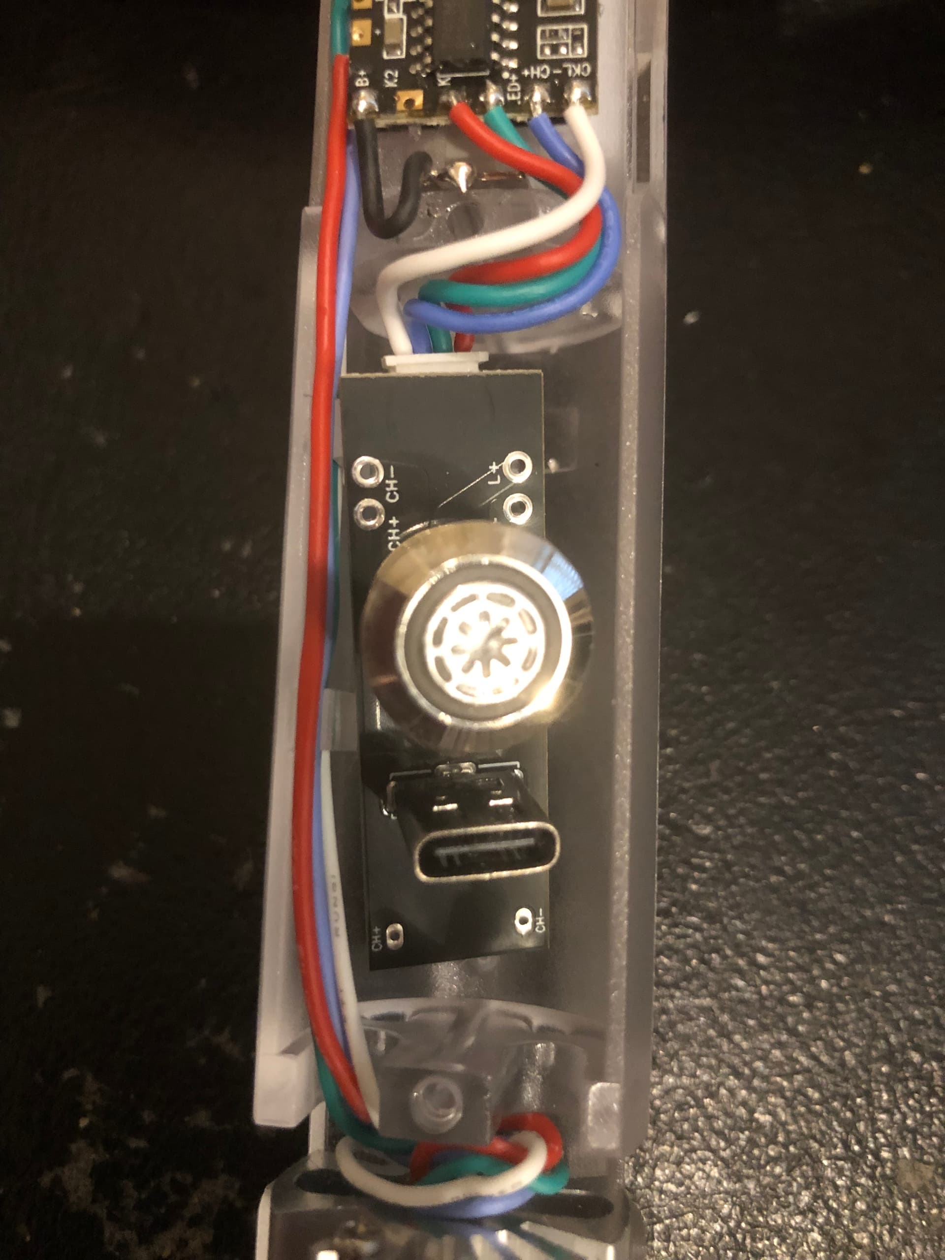

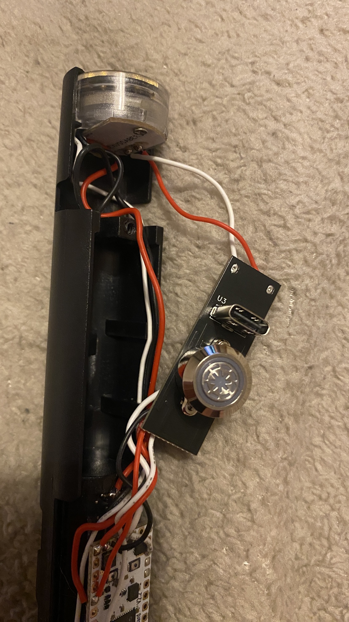

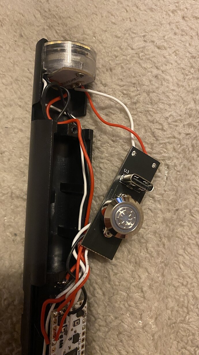

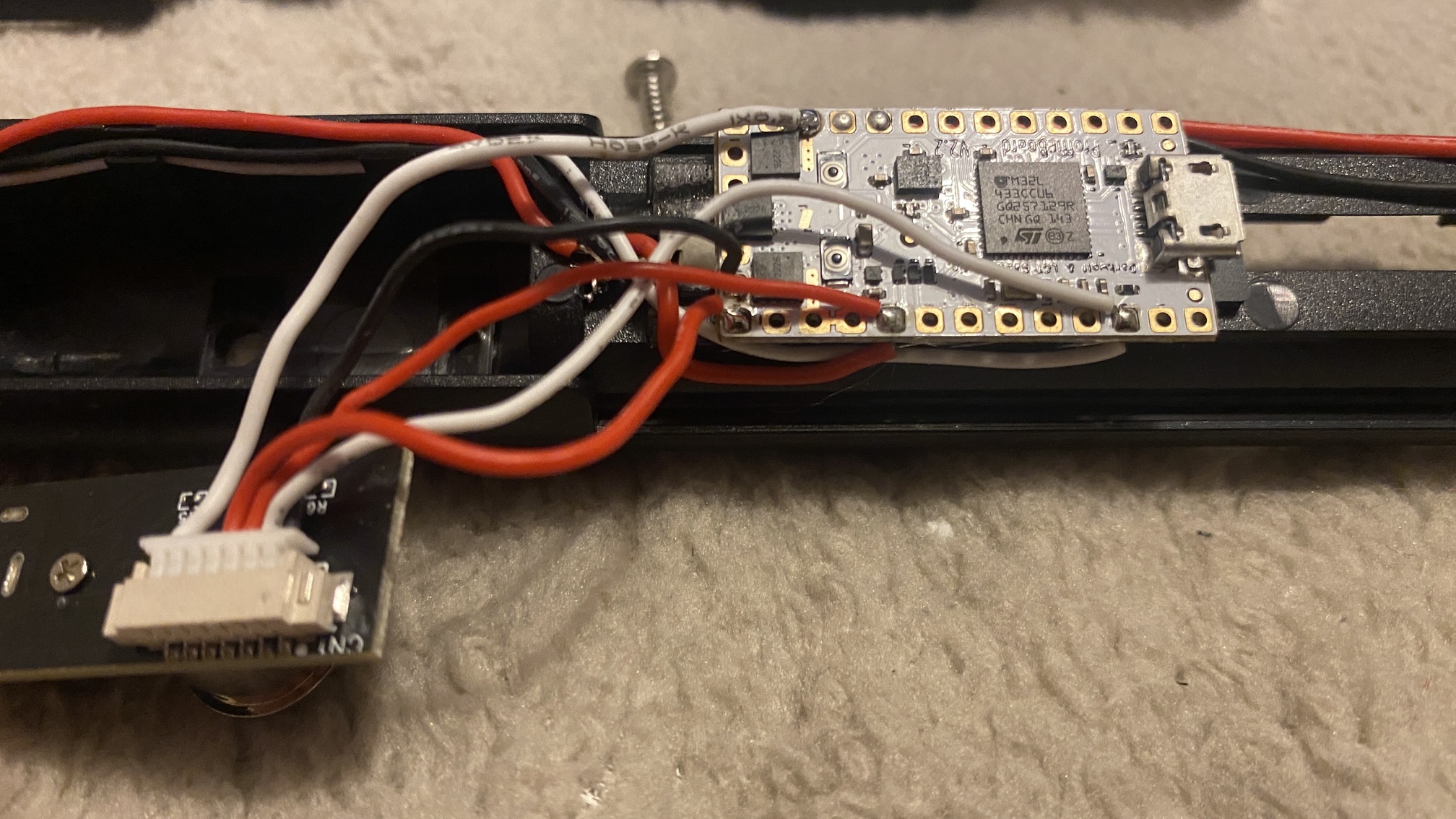

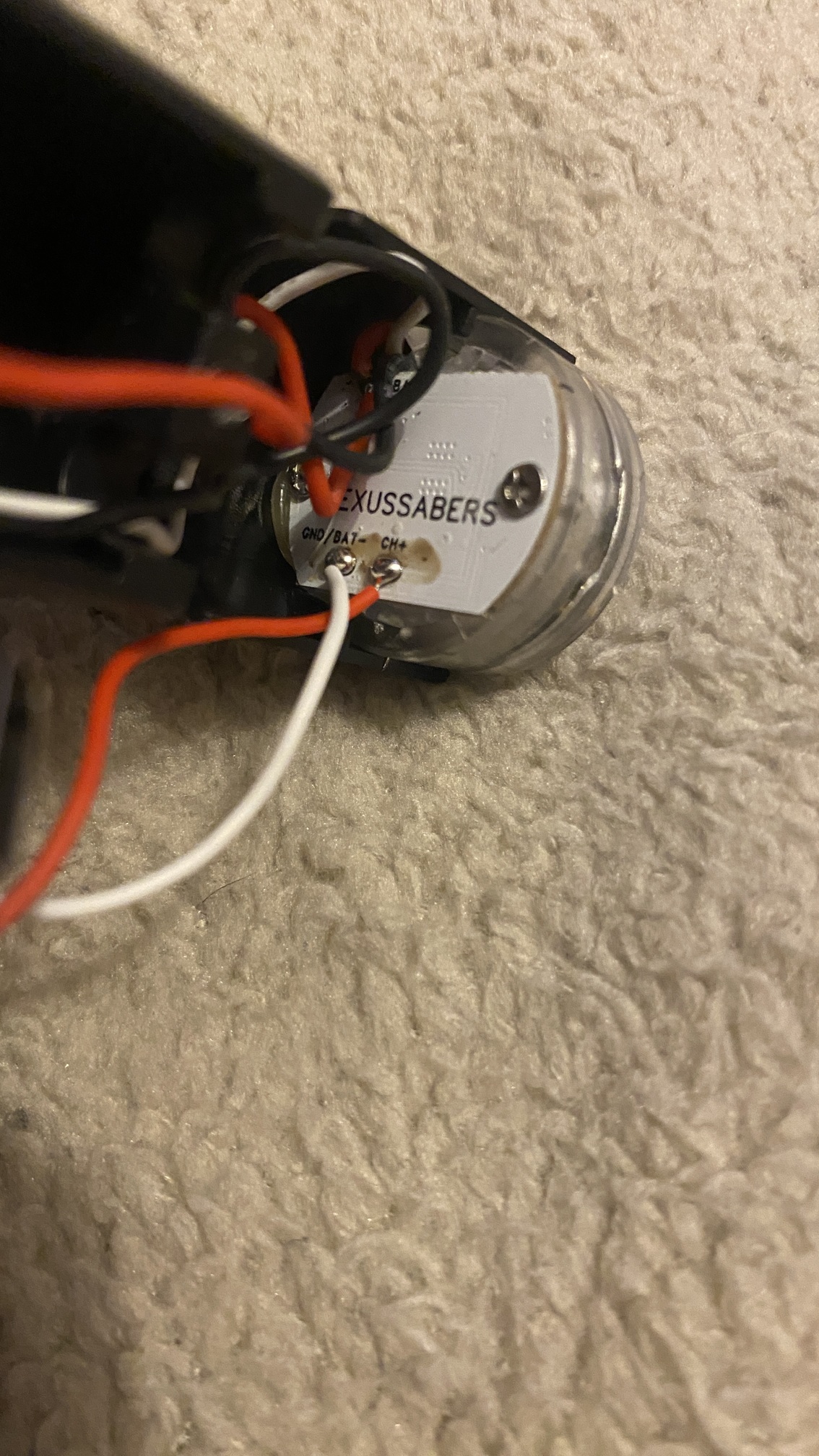

Don’t know if these will be any help but I took photos of the similar looking switch on my son’s lightsaber. The sound board is a Xeno board.

Thank you. It may be of some help. I have some xeno board maps somewhere it may help.

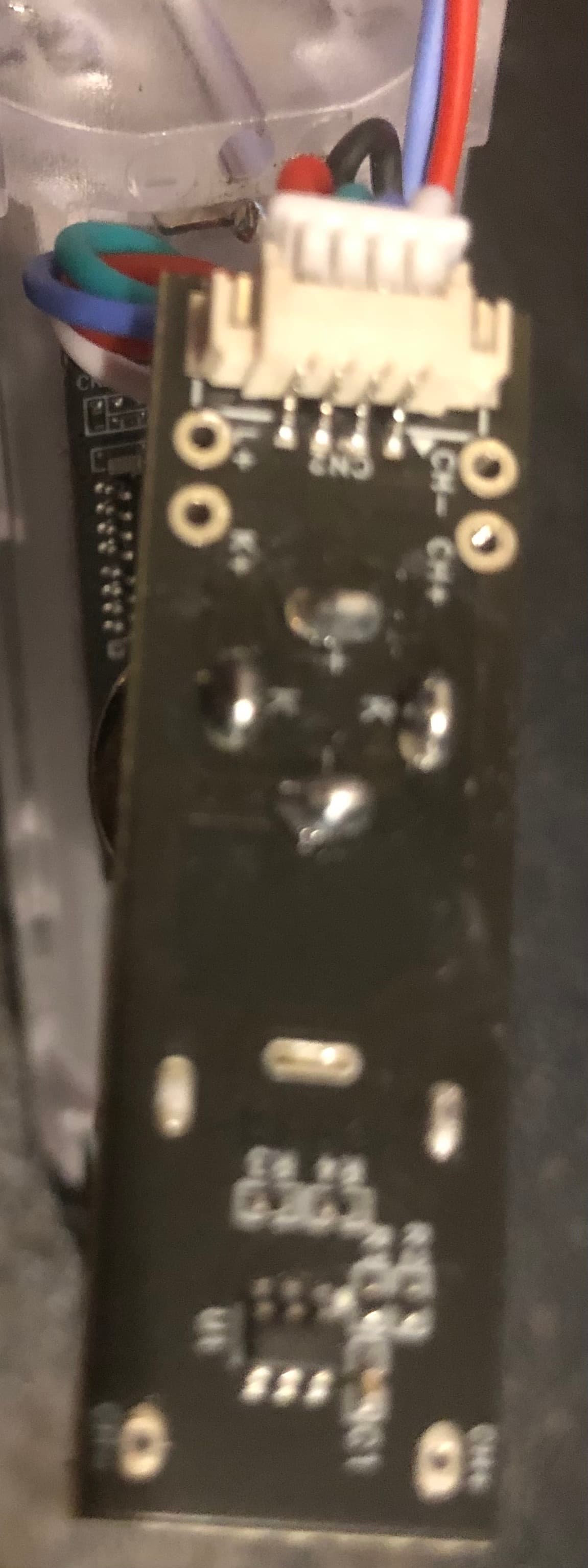

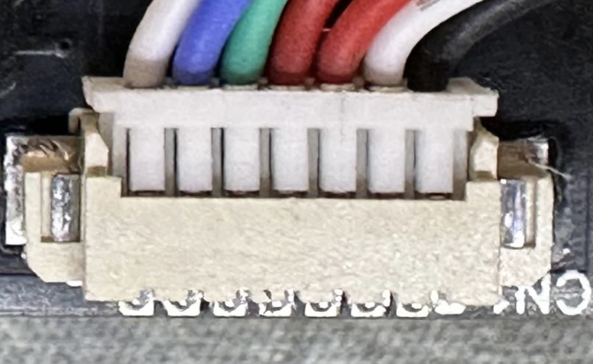

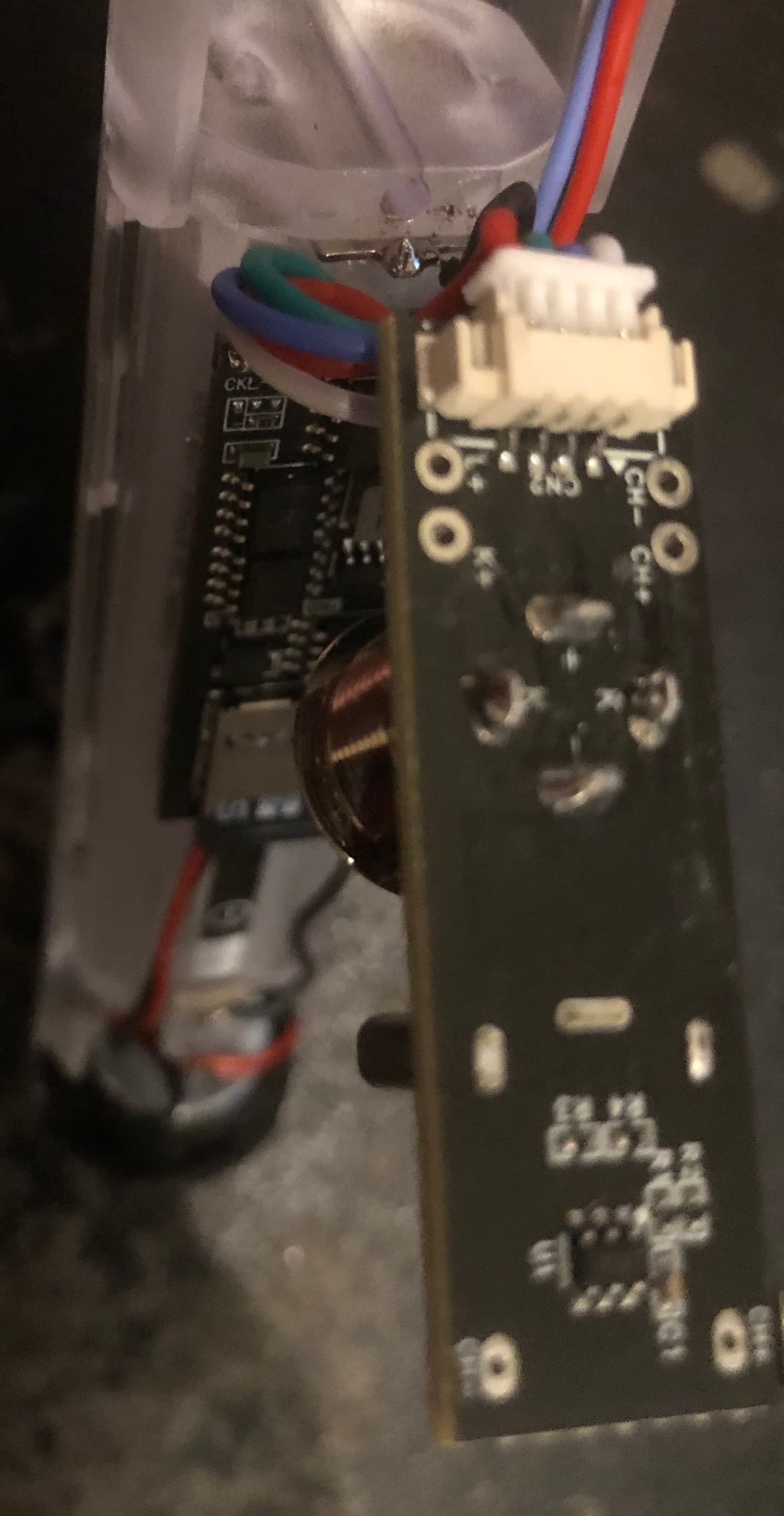

From left to right you’ve got
White = batt -
Red = button 1
Red = batt +
White = data 1
Black = LED2
You sir, are awesome. Thank you so much.
Your welcome
And would blue and green be usb data ? If so, I think I want to one of those too!
indeed, good call
thanks again it worked perfectly.
