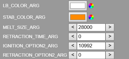

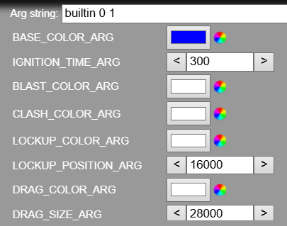

I was wondering about style arguments for style overlays. When you make a blade style on Fett263 website, it gives you the option to add options to style overlay. Then, in config tool, it doesnt have a way for me to actually equip it. How would I go about this?
Per the library,
*Apply an Overlay to further enhance your base style. Editable via Style Option 3 in Edit Mode or Workbench
You can select via STYLE_OPTION3_ARG in config tool.
I dont see that option
Post the style code the library generated.
