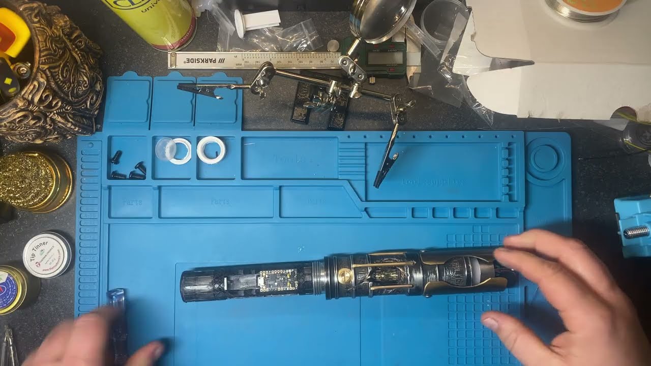

the buttons only start working after i ignite the saber with a gesture, heres a vid to show what i mean.

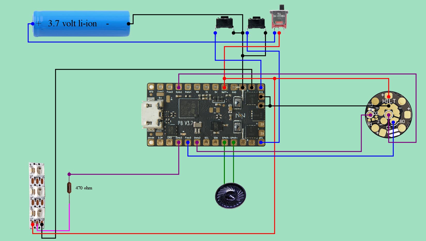

The most likely cause is that you have wired the buttons to one of the LED pads instead of GND/BATT-.
The pixels on the blade connector aren’t firing either, gonna have to desolder and take it all apart :tired_face:
