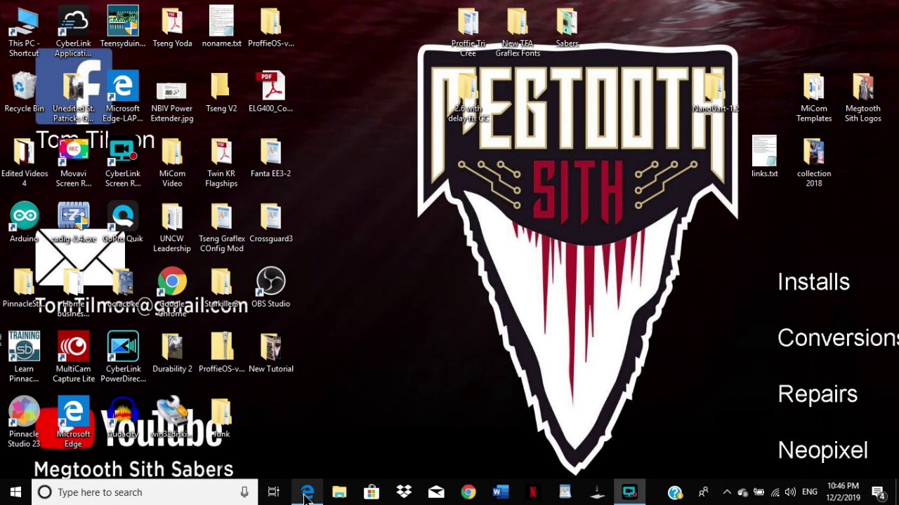

I would highly recommend watching a few times the following videos.
Installation of the board and configuring the proffie
I would also take a look at megtooth siths
