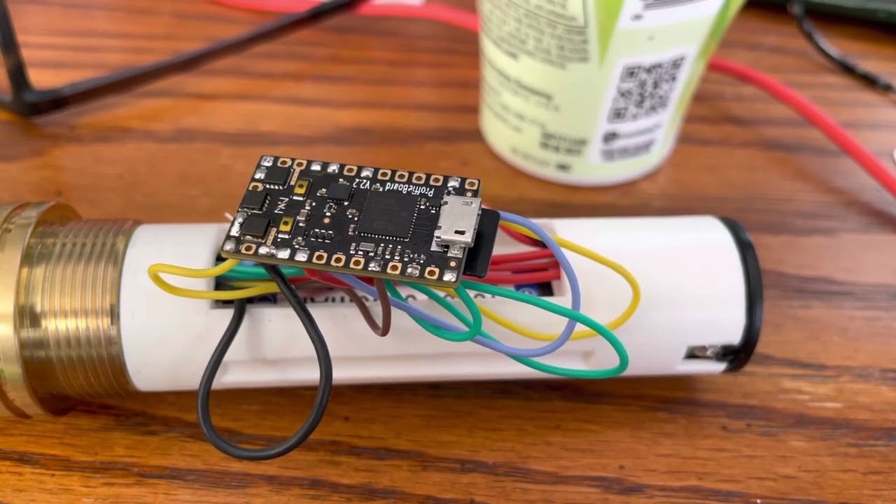

I’m going to replace the speaker wires with something a bit heavier and I think I might rewire the bulk of it for shorter wiring. I initially thought the customer (who lives up the street, so really is just a friend who is getting a free build) would be pickier about the buttons and such so I thought I’d need more slack than I do for disassembly.
The speaker wires go right next to the battery switch, so maybe it’s interference?
Rewired the speakers, went 26awg for total overkill… still doing it. If I give the board enough wiring slack that i’m only moving the board and not the saber, it still does it. Connections to the board are all very solid, so it seems like it has to be the board, but I’m not sure if there’s a way to further diagnose. I certainly don’t see anything odd in my config. I’m at a loss.
You could always try the connecting the speaker and SD card to a known working ProffieBoard. If you do that and there isnt a crackle, you will know its the boards fault.
Also; That is a PRETTY saber! Shame that you are having issues.
I did the inverse - I connected a known good speaker and SD to it. I’ve also changed the ground point from one side of the board to the other. Nothing. There’s a clicking noise you can hear when it’s just sitting running an idle hum as well that makes me think it’s the amp. I’ll upload a video.

Here you can hear it clicking just sitting there playing idle hum.
@profezzorn if you have any ideas about something else to check i’m all ears, but I’m assuming I’m just basically humped at this point. seems like a bad amp and i don’t imagine it’s something I can just fix.
I’m wondering if maybe we’re hitting some protection circuit in the amp. Since we push the amp pretty close to it’s limits, this could happen if either the speaker is in fact lower than 4 ohm, or if the amp is just a bit out of spec. If that’s the case, a reasonable solution might be to add a small resistor (1-2 ohms) in series with the speaker. (And possibly push the volume a bit higher to compensate.)
If this doesn’t help, I might be out of ideas for how to fix this.
Is that clicking rhythmic? I distinctly hear a repeated pattern there, not random. 2 slow quiet clicks, 2 loud quick, repeat.
