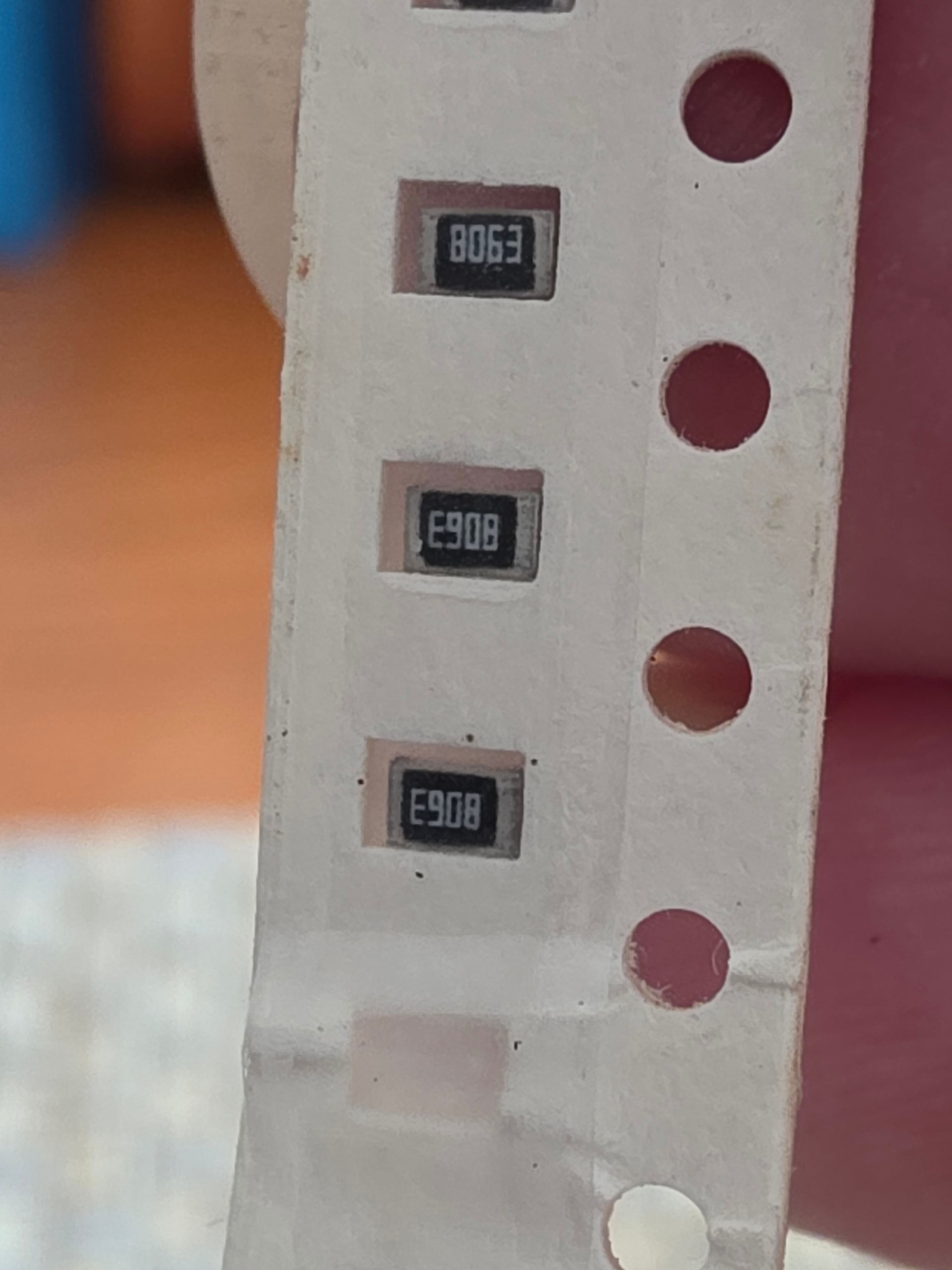

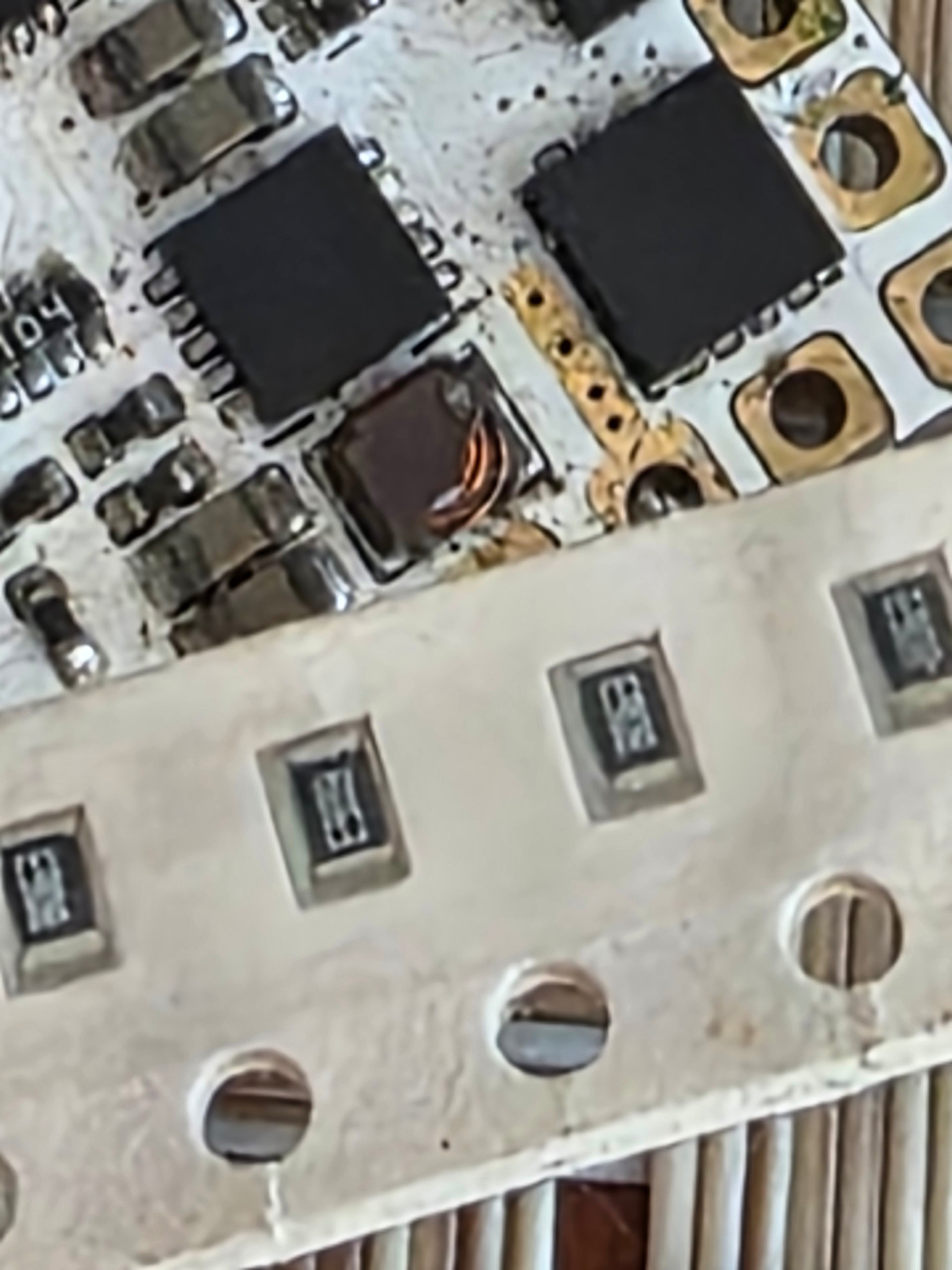

so i’m doing inventory on this. and I found this proffieboard but the l1 component I have are a lot smaller then that component that is exposed.
Here’s a current photo with L1 component
Looks like they substituted the part (cheaper if I had to guess) The inductor on my board I have here is an SMD one.
So long as the replacements you have there are to the proper specs, it’s fine. Just a different form factor.
Though, yours do look a little small…
The mouser image for the part linked on the V2 BOM is more what I’d expect such an inductor to look like. I can’t say I’ve seen an SMD inductor that looks like that, but maybe they exist (the small SMD ones I’ve seen aren’t typically labeled like that, and are marked differently if at all). I’d be worried about its current ratings if it’s that small though.
Is that 1.0uH 4.0A?
Do you have a data sheet link?
