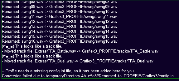

Yes, I can’t copy the text, so here is screen.
Screenshot 2025-01-23 072231
Maybe something to do with creating the ini?

Please PM me. I want to try with your actual files. I am having no issues with everything I throw at it.
Ok so problem was discovered and fixed.
The issue was feeding the converter an already-Proffieized folder, but telling it it was getting CFX.
Bottom line, adding the default config.ini and smoothsw.ini files process was borked because they already existed when they were expected to be missing.
Resolved and updated the site.
Now, even if you upload a different board’s naming convention than what you choose, this .ini file thing won’t be a problem.
