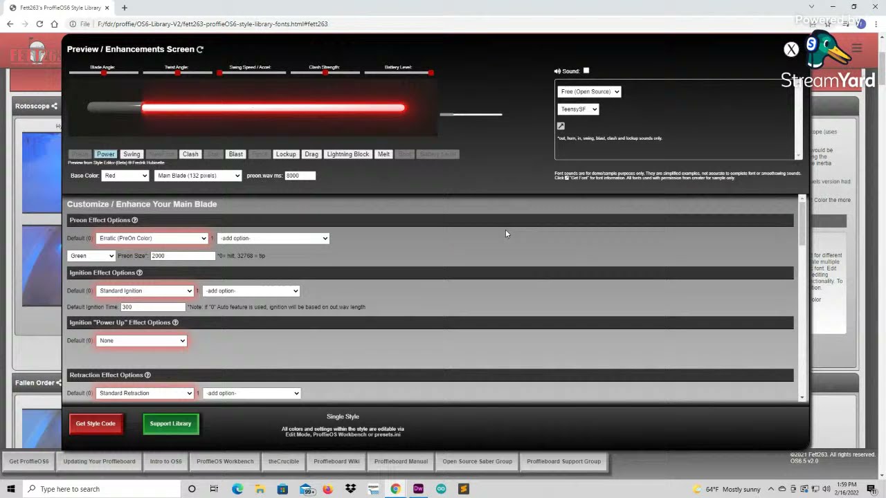

The “cat got let out of the bag” so I figured I’d just make this a “Sneak Peek”. I’ve begun development on PHASE 3 of my Style Library which will now include several new font capabilities to preview and match the styles with fonts.
Font Preview - the new preview screen will allow you to use samples of various fonts and test how they work with the styles and effects as you build them in the library. These will be sample sounds (so not the full font just: preon, out, hum, in, swing, blast, clash, lock). Then when you find a font you like you can click the “Get This Font” icon to link to the font’s purchase/download site. I am working with the Proffie font makers to get any fonts they want added and categorized in the library so users to preview and link to.
Font Matching - in addition, there will be “Match Font” option which will show only the matched fonts based on your current style. These are based on the styles the font makers recommend and/or think work best.
My Font - finally, the Library will also let you load up samples of fonts you already have and see/hear them with the styles before uploading to your board. You can select from the available sounds and browse your computer to “load” them into the previewer. The sound files don’t actually get uploaded anywhere, they are used temporarily by your browser from their location on your computer. If you close the browser or leave the page they will need to be reloaded.
This will let you preview the various styles with fonts you have to see how they work together, particularly for preon effects. All preon effects in the library auto-time themselves to the specific preon sound, so now you can load up your preon sound and see how the preon effect will look based on that sound.
