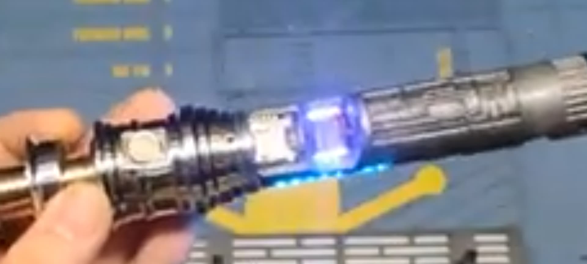

Hi, i have a little Problem. I have a single color led build in the Proffie and have made a style with the sequencer on your Web. But it didn’t run. Is it wrong?
I need flicker led if it’s on and dim pulse (smooth) if it’s off to simulate Energie Transfer from battery to the board.
Thank you
Best wishes
Garo
