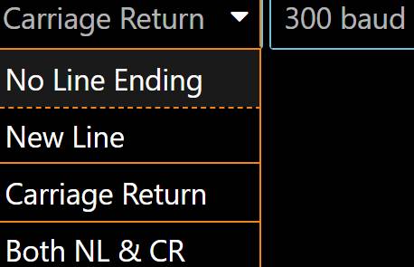

Also what does the two drop down lists do and do they have any influence on reading ProffieOS serial monitor output:
ArduinoIDE
I am guessing that the “baud” list defines the max speed at witch serial monitor will receive/read information from the ProffieBoard ? What about the other one with “No Line Ending”, “New Line”, “Carriage Return” & “Both NL & CR”? And witch one am I supposed to select ?

What version Arduino?
Leave it on New Line.

I don’t actually know, does stuff like sdtest appear correctly in Arduino? I had to go and handle the carriage return properly in ProffieConfig to make its Serial Monitor (macOS and Linux version… the Windows one is still sad and I haven’t gotten around to making it use ProffieConfig’s GUI) behave proper.
I’d also wonder if the Windows version of Arduino behaves differently from the macOS version, since the meanings of those control characters vary. I’d think not though, since the frontend is Electron now. :face_vomiting:
Baud rate only matters if the serial monitor is connected to a real serial port.
Proffieboards do not use real serial ports, they are virtual serial ports running over USB, and the speed is entirely ignored, so you can set it to whatever you like, it dose not matter.
