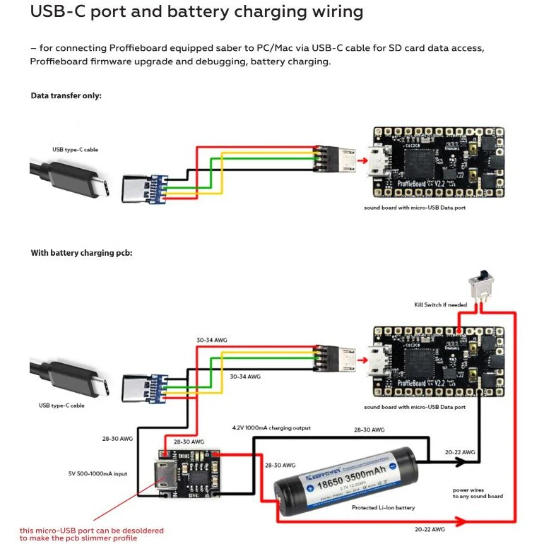

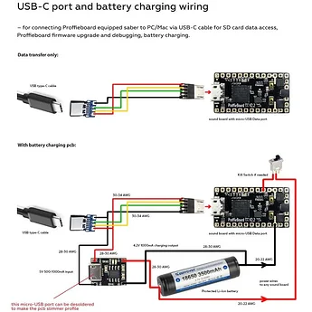

I was reading this thread and I remembered something I saw on The Saber Armory. USB Type C Port and Lithium Ion Battery Charging Kit – The Saber Armory
I’m not sure this could be the solution, but the lower part seems like a similar configuration like the Seedling V2 (but combined). Or will this also not work with a v3?
Perhaps by using the killswitch like in the lower image, the board won’t charge the battery, but the seedling does. And because the seedling is fully connected to the proffie board, the board does get power for data?
Any thoughts? I could be wrong :man_shrugging:
No, this is my diagram from the Proffieboard PDF User Manual and it works with a separate charging board because it’s not “smart” like Seedling V2. Here VBUS 5V is always enabled directly from the USB cable and powering Proffieboard MCU and its onboard 450mA charger, so to make the separate 1A charger work you have to disable the Kill Switch here or also not connect the VBUS wire. Seedling V2 is a little bit different situation.
