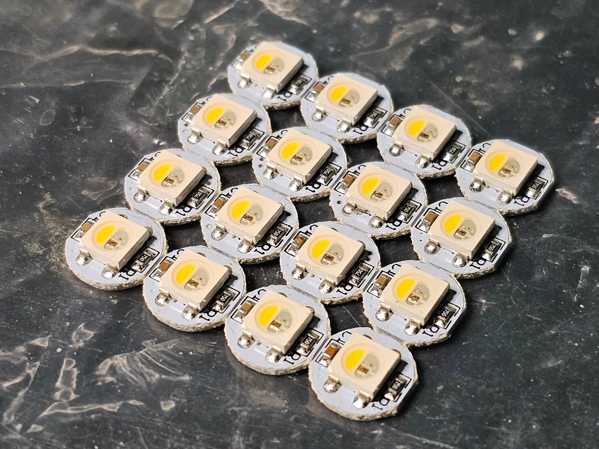

Hello all. I’m trying to use these rgbw chips for my crystal chamber and the only color that doesn’t seem right is royal blue as is activates the yellow side of the chip giving me a faded blue. Is there a way for me to avoid this by adjusting my config?
No, unfortunately this is an optical problem with the chip, not with the signals sent to it.
I recommend RGB chips instead of RGBW chips.
Okay thank you, I got these for their cool white feature. I’ll have to try another method
Regular RGB pixels can produce cool white colors, they just don’t do it for Rgb(255,255,255). Maybe try Rgb(240,255,240) ?
Nice. I’ve been messing with the values for a while but could never get ti just right. Thanks
Yeah gonna keep that one in my back pocket too!
I just made these values up, I did not actually try them…
