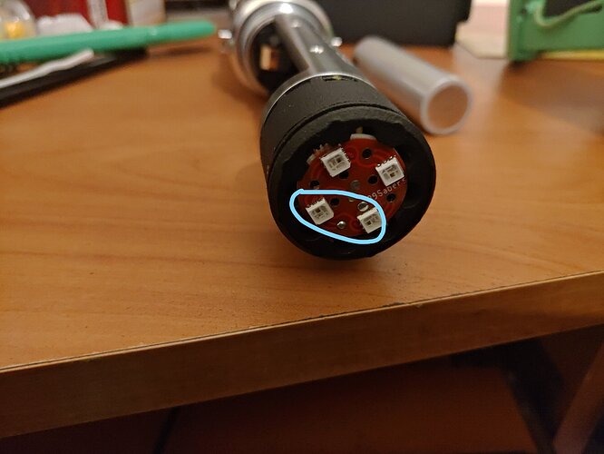

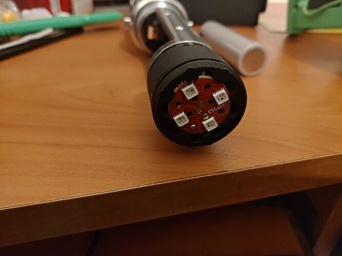

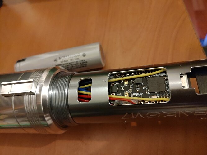

I recently bought a npxl saber (kestis hilt) which has a chamber in the bottom. Factory fonts and config was pretty lame, so i learned how to flash the board and applied my own. Sadly now i can’t manage to get the 4 RGB LEDs from the bottom to ignite (they were working perfectly, matching the colour of the blade before i flashed and changed config). Since i’m not the one who built the saber, i’m not sure where are those 4 LEDs wired to the board, and don’t want to dismantle the saber -.-. Can anybody help me with the proper code for the chamber to work? here’s the config file i’ve been trying :

{ 0, WS281XBladePtr<144, bladePin, Color8::GRB, PowerPINS<bladePowerPin2, bladePowerPin3> >(),
WS281XBladePtr<4, blade2Pin, Color8::GRB, PowerPINS<bladePowerPin4, bladePowerPin5> >()
, CONFIGARRAY(presets) },
