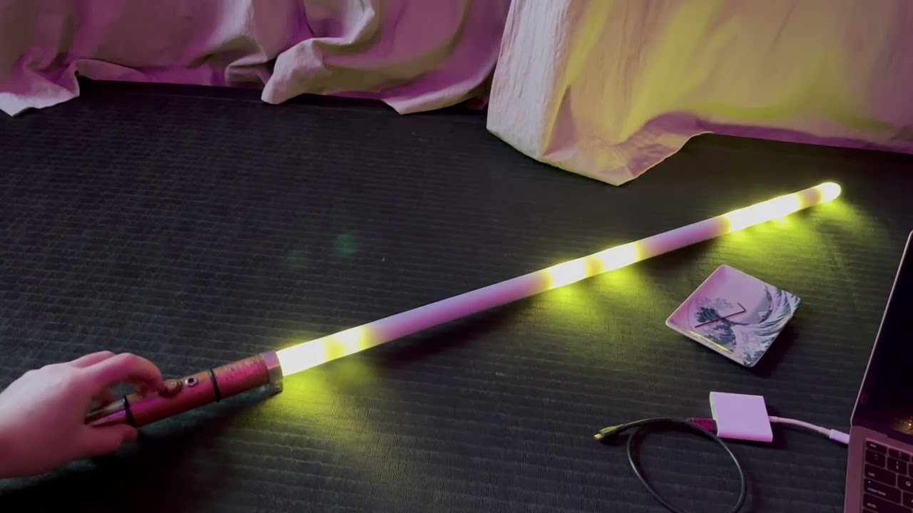

I did an initial test. The original physical prop is in there (the hat running Fran’s Fireflies) for comparison. Found a loose wire in it so two of the LEDs are not functioning.
I’ll try adjusting some values but any further suggestions are welcome and appreciated.
EDIT: The fade at the hilt is very nice during retraction. Looking for that smooth up, random hold, smooth down vibe…

Looks perfect in the editor.
Same look as in the previous video on the Proffie 2.2, using OS7.14.
Tested, confirmed it looks the same as video above on the board.
I think I figured out the problem.
I have a fix checked in on github master.
Please give it a try.
That is a beautiful little style. Tested and confirmed working.
Thank you!
EDIT: Video added
Nice, guess I’ll have to release a 7.15 update soon with this fix in it.
