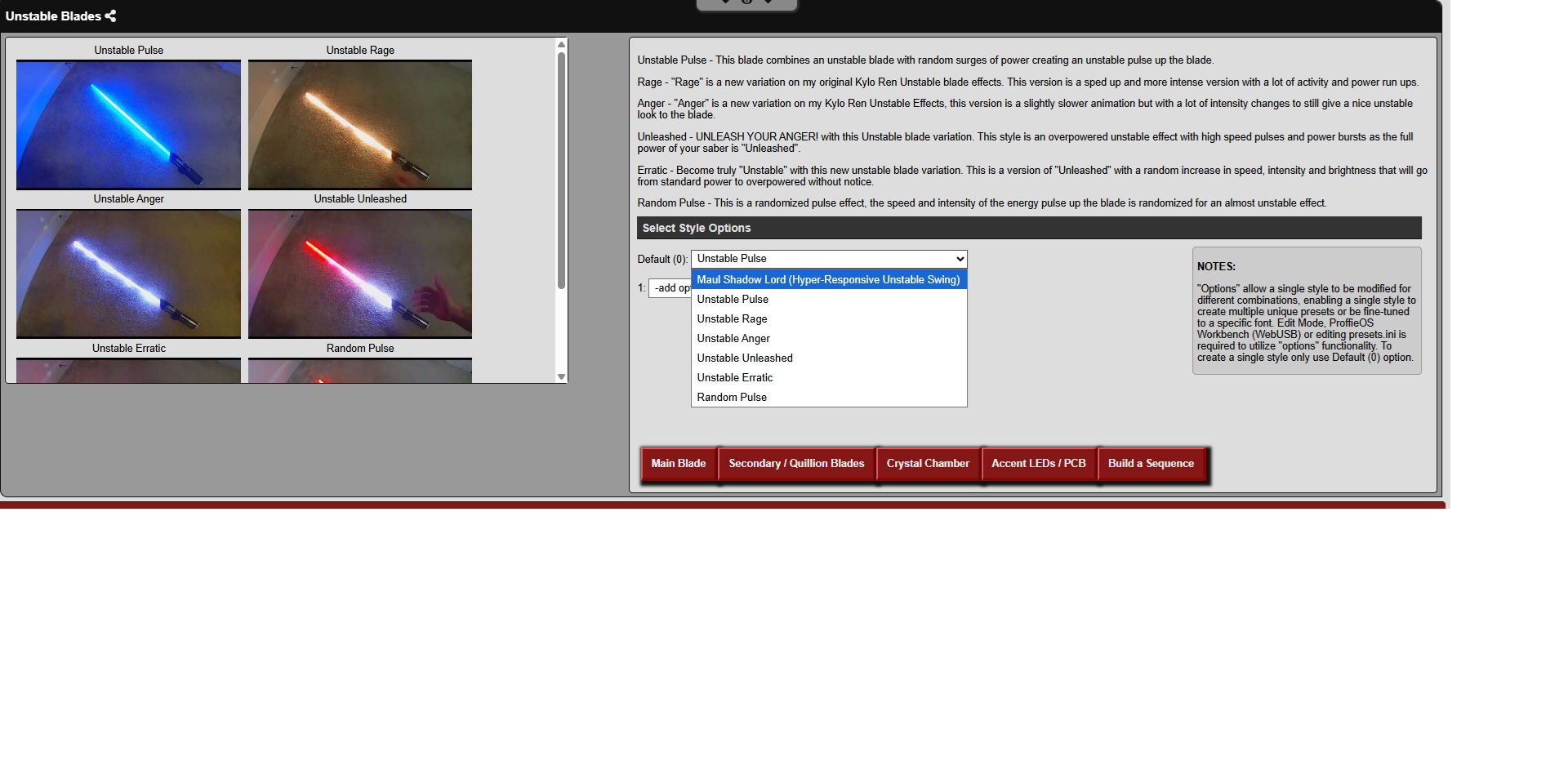

I have also added a new Style under Unstable Blades for the Maul Shadow Lord effect.
The effect has a uniform Unstable effect at rest, blade movement or swings will add more instability at the tip of the blade, the size and intensity will depend on the speed and acceleration of the swing.
Unfortunately, I didn’t have time to fully test or shoot a video, but feel free to try it out.
