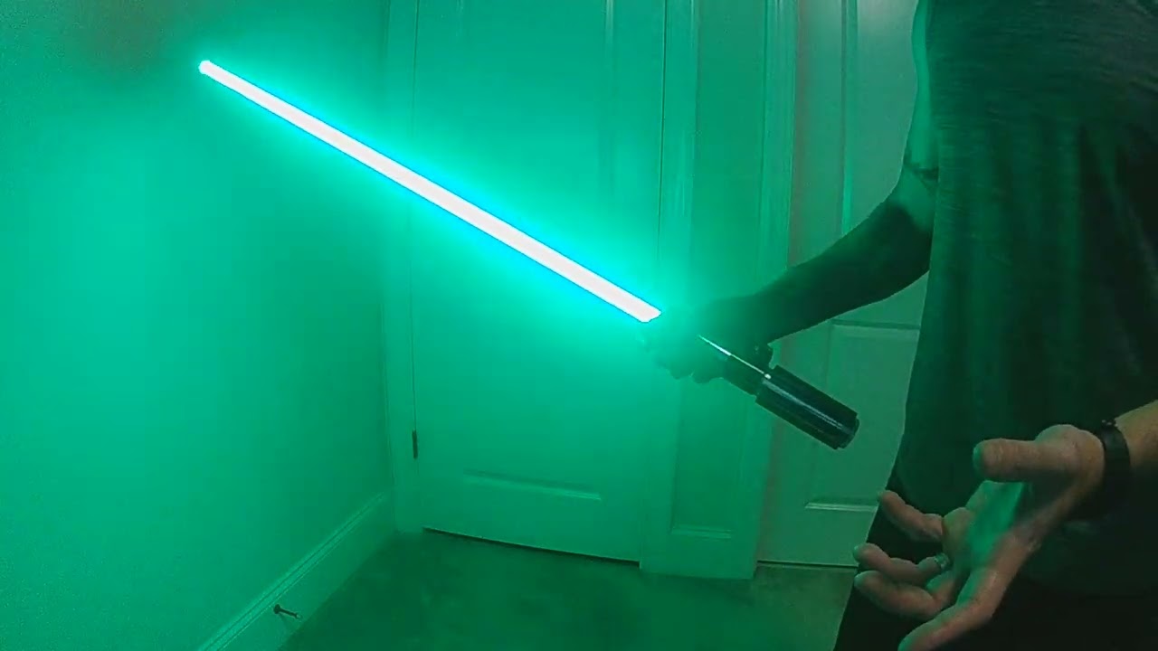

Early Access Update - The Acolyte - NEW “Change Phase (Corruption)” / “Pull to the Darkness” Special Ability Library Demo
Minor spoiler -
I have a new Special Ability / Transition called “Change Phase (Corruption” coming to my Early Access Library. This new ability will allow you to build your own custom Multi-Phase blade and set up a new Corruption phase change to mimic the season finale of the Acolyte.
This new special ability features a custom animation that mimics the show with a jagged corruption of the blade from the hilt up as you are “pulled to the Dark Side”. The phases will “battle” up the blade with the new phase eventually overtaking the blade fully. Only after the new phase has fully overtaken the old one will the font change, just like in the episode.
I’ve been working with a couple of font makers who have fonts forthcoming to support this new capability.
The library will allow you to build your own Multi-Phase (Special Ability) style and then set out either or both methods of Corruption, in addition, since this is a Multi-Phase Blade you can also set other normal Phase changes up for the Special Abilities to your liking.
  • Special Ability 1 ~ 4 option = “Change Phase (Corruption)”
    Trigger the corruption anytime you want using the Special Ability of your choice. Uses a new tr sound for the actual corruption and then changes the alt font once the new phase fully overtakes the blade.
  • Special Ability 5 ~ 8 = “Ignition + Change Phase (Corruption)”
    This is a special ignition that will then trigger the corruption. You can use your normal ignition to have the blade ignite normally and then when you want to mimic the episode and have it automatically corrupt after ignition you can use this Special Ability. You can also delay the corruption effect so the blade will ignite and wait before the corruption begins. Uses a new tr sound for the actual corruption and then changes the alt font once the new phase fully overtakes the blade just like the episode.
    Because this uses the Multi-Phase builder you can choose more than 2 phases if you want and have multiple corruptions if you want, in addition, you can set up the Special Abilities however you want so the style can be used multiple ways within the preset.
    Be sure to keep an eye out for the new fonts from a couple of your favorite font makers, to go along with this new style :wink:

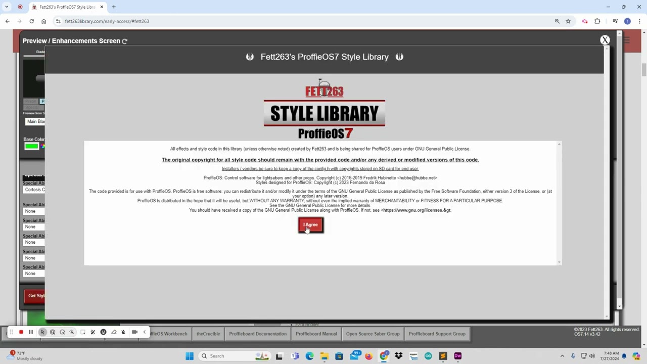

As with the original Cortosis Clash you can add this Special Ability to your blade style on the Enhancements screen. The library will generate the instructions for set up of the new sounds in the Style Information section at the top of the code. This section is very important for OS7 styles and should always remain with the style code, it is ignored by Arduino and has no impact on memory.
Demo to set up new Feature here:
This new Special Ability is available for my Early Access Patrons here:
