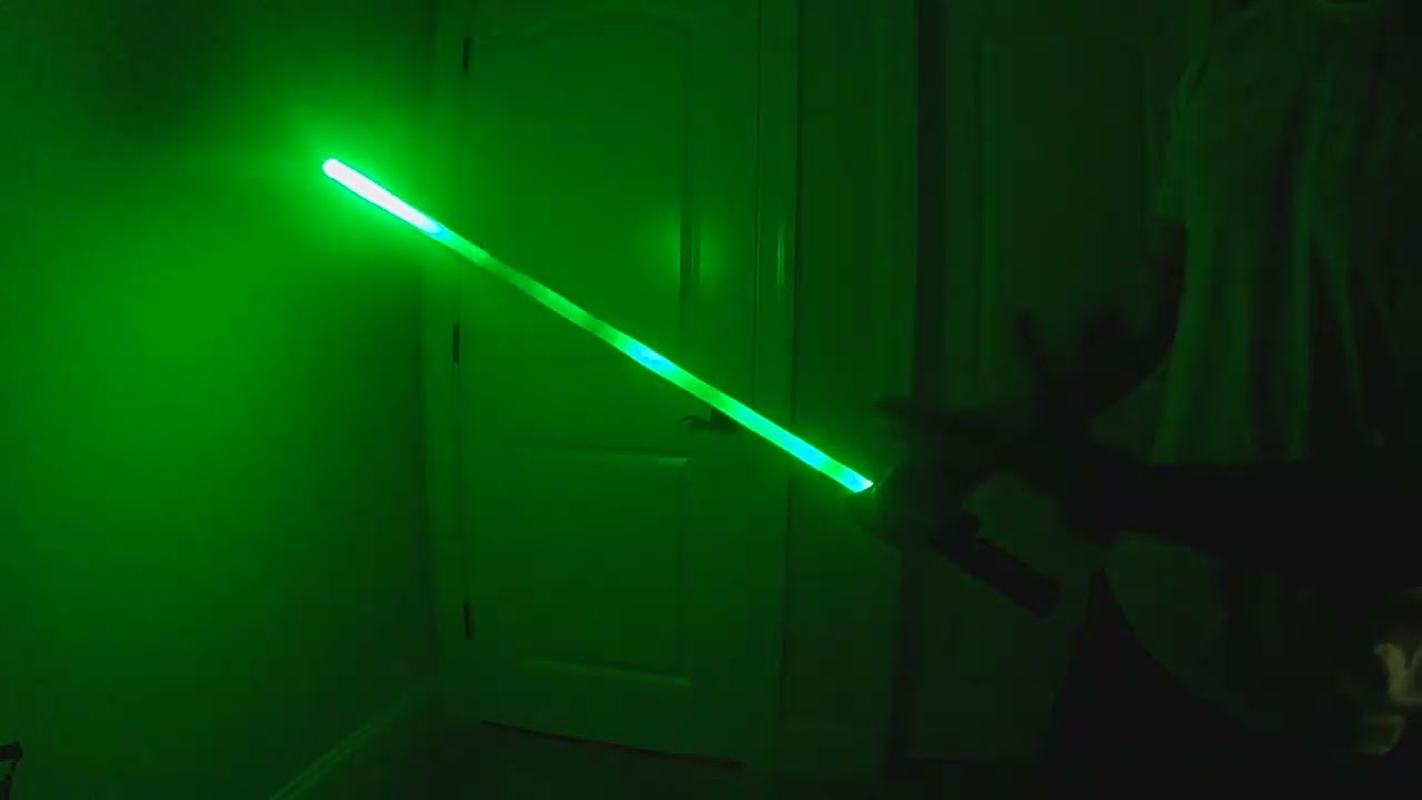

Phase 2 should be launching this weekend, just need to finish a few small items and shoot a few demo and explanation videos. I’ll be posting those here and will make a formal announcement when Phase 2 goes live.
A few more videos, should be launching Phase 2 tomorrow afternoon just need to clean up a few things and do some final tests and one or two more demo videos.

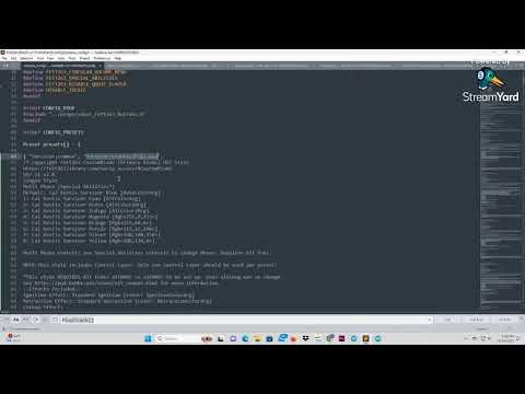

This video is important in understanding set up for the new sounds to support the upcoming features in Phase 2, it will be posted at the top of the library as well as recommended viewing.

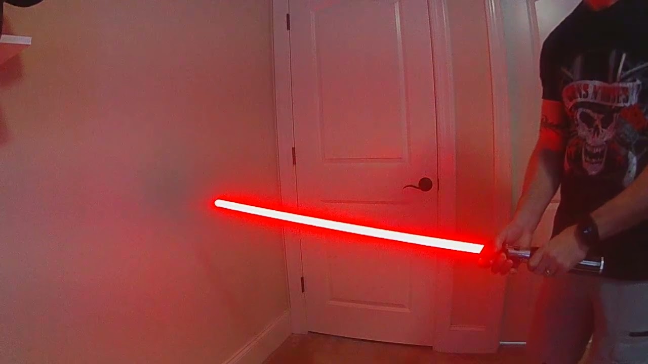

Demo of style built in Phase 2:
