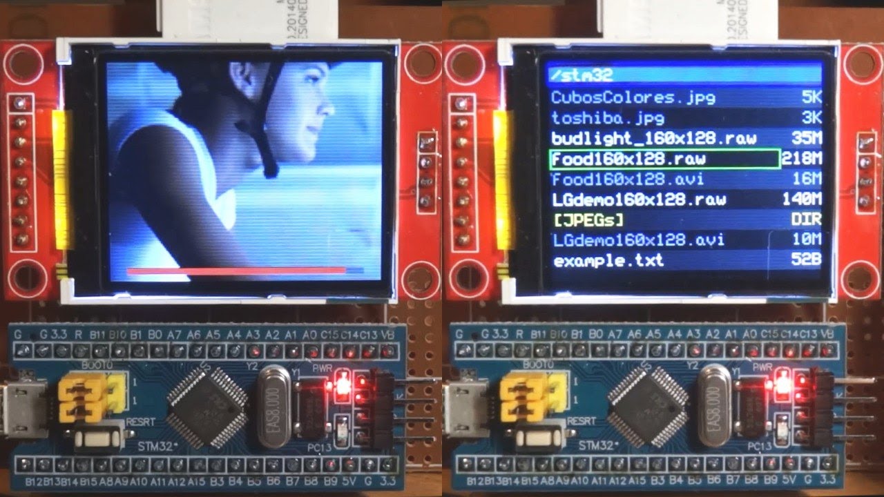

Or something maybe like this for making blasters and helmets with displays?
I do plan to add support for color displays eventually, but it’s probably going to require a Proffieboard V3. The V3 will have faster SD access, more memory and available SPI pins, all of which might be required to make color displays work well.

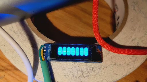

Something about the latest display updates broke OLED for me. It was flying and working great previously.
Now, it plays boot.pbm fine. Then turning blade on, it shows on.bmp clearly only for a blip, then goes wonky.
If I do blast, clash or lock via serial monitor, it shows the image clear for a blip, then goes wonky. Endlock (returning to on.bmp) shows same, clear for a blip, then wonky,
See vid: (hopefully this link works to make life easier than uploading to youTube)
I think the animation problems should be resolved now.
Confirmed. Working well, thanks.
