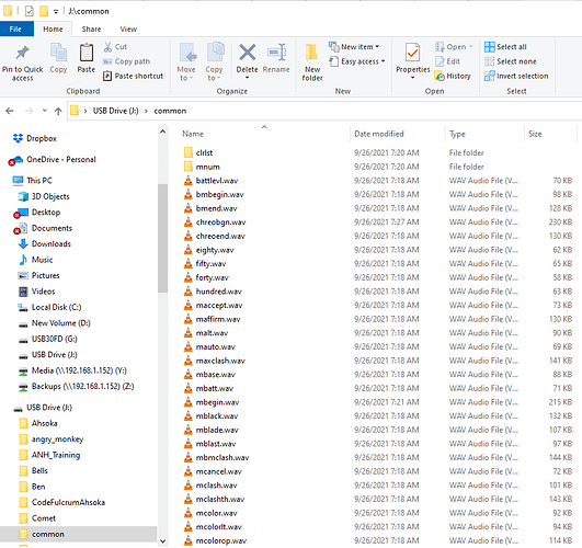

I created a root folder on SD card titled “common” that contains the downloaded wav files from ProffieOS_Voicepack_English_C
I had it work briefly, then lost it again. According to the documentation, I hold the power button and click the aux button. I only heard it ONCE say, volume menu. and then beep as I turned it, then had it say minimum volume.
Now when i hold power and click aux, and turn it, then click button to confirm, i get zero confirmation of volume change but it does actually change it.
check the sd card preferably remove it and put it into a sd card adaptor and insert it to the pc and see if you can play the file as shown by @NoSloppy. files missing when they are there are generally an sd card issue. you can also test the sound using the serial monitor, by connecting saber to your pc with a usb cable and open the serial monitor and try to trigger the volup.wav you will see it in the monitor.
I removed the sd card, connected it directly to PC, deleted the root common folder, reuploaded it, safely ejected it, and i still do not have the audible confirmation. the actual gesture control still controls the volume though.
For the life of me I cant see how to go back and edit my post, but here is my config -

Ok this is even stranger - The volume audible feedback works on SOME lightsaber fonts, but not all. I have one particular lightsaber font in my config that works as designed giving me “volume menu” audible menu entry, beeps and boops as feedback and volume menu end. without powering off the saber, i can change the font, and that next font may or may not have the audible volume menu feedback!
the common folder will find the “missing” fonts for the menu edit mode, but if the font has that file within it, this will be used instead, what I would recommend in doing is to check whether you have all the files in the common AND if there is any missing in both.
the list is below.

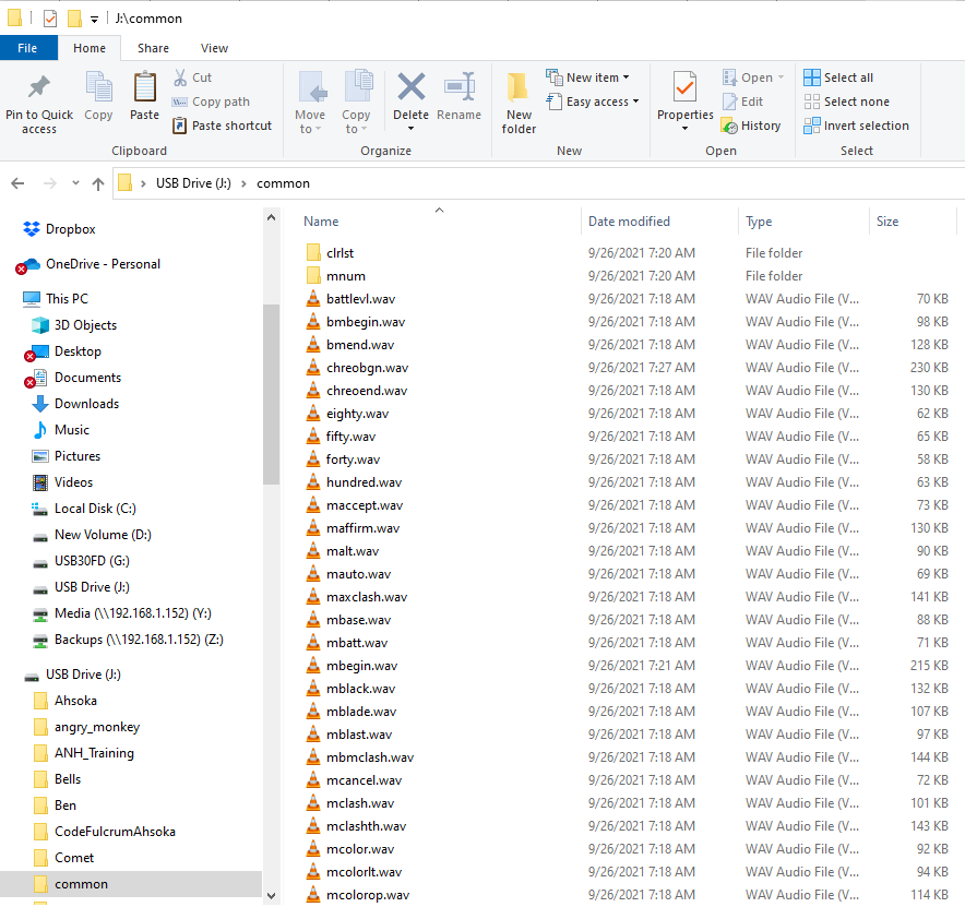

My common folder on SD card, has 143 files the full content of the proffie package voice english C.
I wiped my entire SD card and recopied all my font folders, including common folder, to the card, and now the volume context menu doesnt come up at all on any of the fonts.
mine is 187 including the contents of the mnum and crllist the main directory on mine is 138 but as mentioned, you need to check the font directories and see if you have any duplicates in the font directory.
if the file in the font directory is present by name but say it’s not formatted correctly then you may find that the file doesn’t play.
