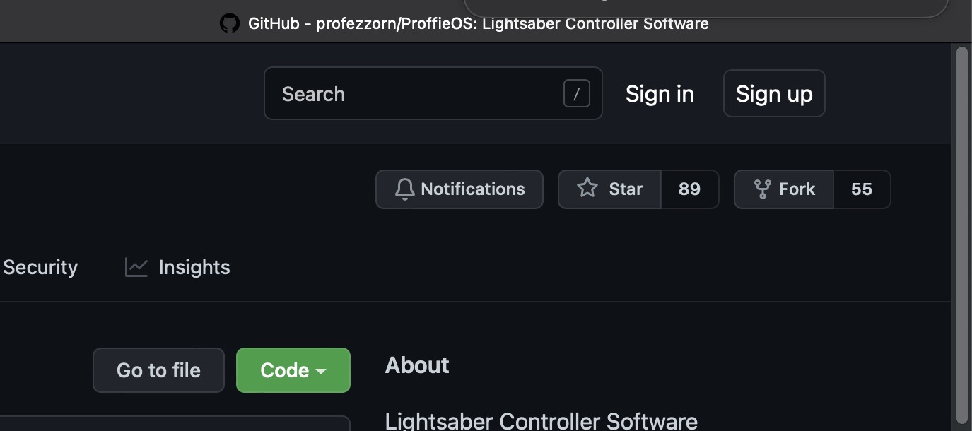

Suggestion: In suggesting to use the most current updated version (Master) of 6.1 as rolling changes occur mention you need to click the green block for that download.
re: GitHub - profezzorn/ProffieOS: Lightsaber Controller Software
