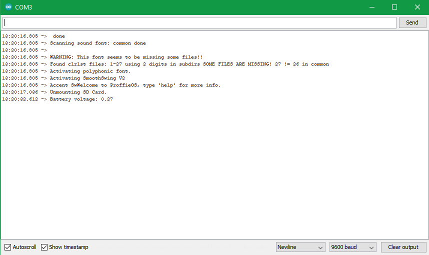

Every time I test a new config I get the message ā€œerror in font directory.ā€ Serial monitor gave me this. Is there an issue in my config folder? I havent messed with it at all
Nevermind, solved my own problem. It was missing clrlst24 for some reason.
