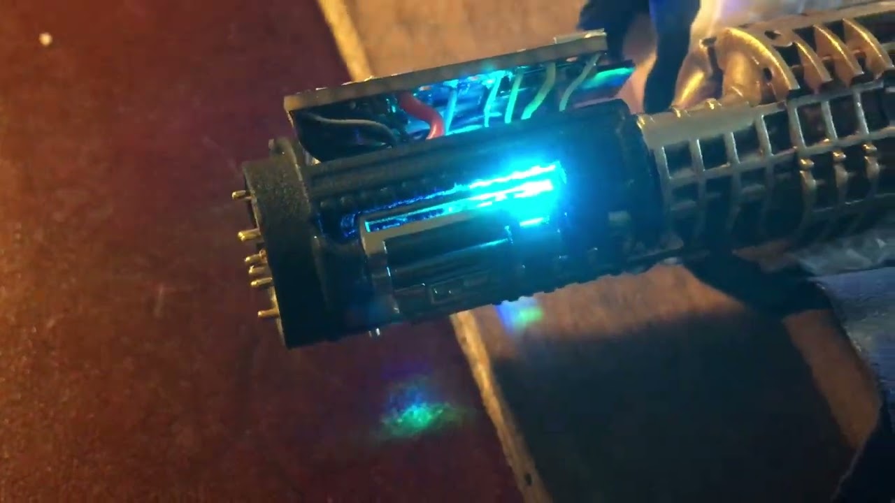

I’m finishing up a busy little install and the front accent strips are flickering white using OS 7.5. But if I go back to OS 7.0 they work fine. Tried uploading both versions twice, both times with the same result. I also had some of the LEDs freeze full white under 7.5, but I don’t know what caused it and I couldn’t recreate it once I got the camera out.
Config is below. It’s busy but nothing too complicated. The strips in question are described in the config as Accent Strips, Short, Front and are fed from shared LED pads with the main blade but have their own data line (Data 3). Blade array has them as a reverse sub blade so I could get the direction right (as they are wired from the front).
The only other funny I’ve done is to have Blade Detect set up to Pin 8 (RX) so that when the chassis is inserted inside the hilt, everything runs the same as outside the hilt except the spinning motor is set to not spin (so it doesn’t make a noise or cause false clashes, as you can’t see it anyway once it’s in the hilt). I haven’t been able to test that yet as I need to glue the board down, and I don’t want to do that until any other wrinkles are ironed out.
Let me know if it’s something I’ve done wrong in the config, but if not, here’s hoping it’s an easy fix. :crossed_fingers:
Here’s a video of the symptoms:
And here’s the config:
