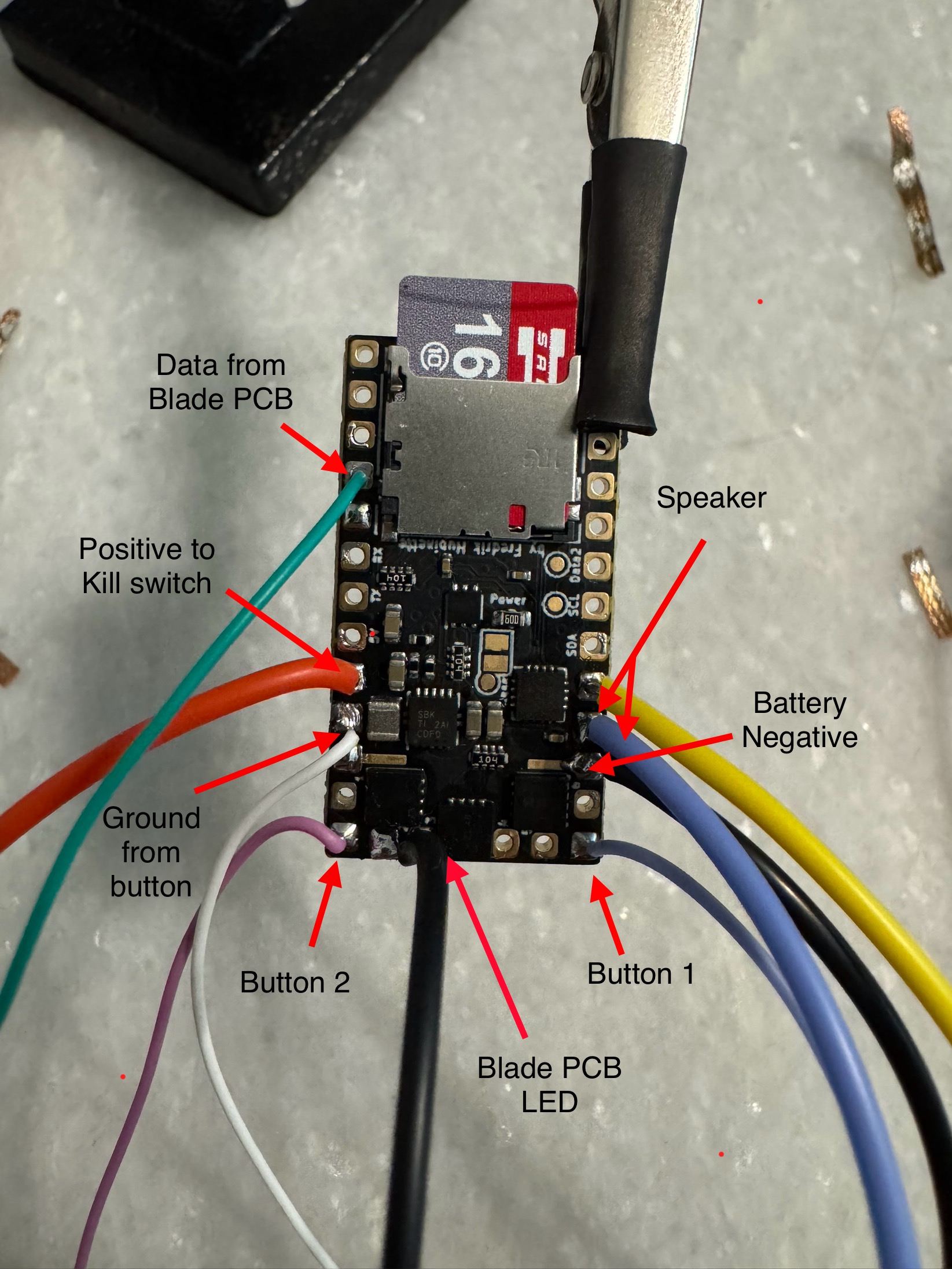

Hello all. I’ve installed one proffie saber before and it went fairly smoothly. I’m having some issues on my second go around. I wasn’t getting any sound or light to the saber, so I completely disassembled to try again and am getting the same. Does my wiring look as it should? I will attach a photo. And if it looks okay, what could I check next for a solution? Thanks so much for any help
Would need config you’re using also to help. Is your led from pcb wired to both led 2 and led 3?
Them some chunky speaker wires
Here is the config, and i have led 2 and 3 bridged on the other side of the proffieboard.

Yeah I don’t know why I used 22 awg for the speaker lol
Does the board connect to the computer properly?
Does the serial monitor say anything interesting?
Do you have battery voltage between GND and BATT+? (measure with multimeter)
Do you have 3.3v between GND and the 3.3v pad?
Do you have 5v between GND and the 5v pad? (When it’s supposed to be playing sound.)
