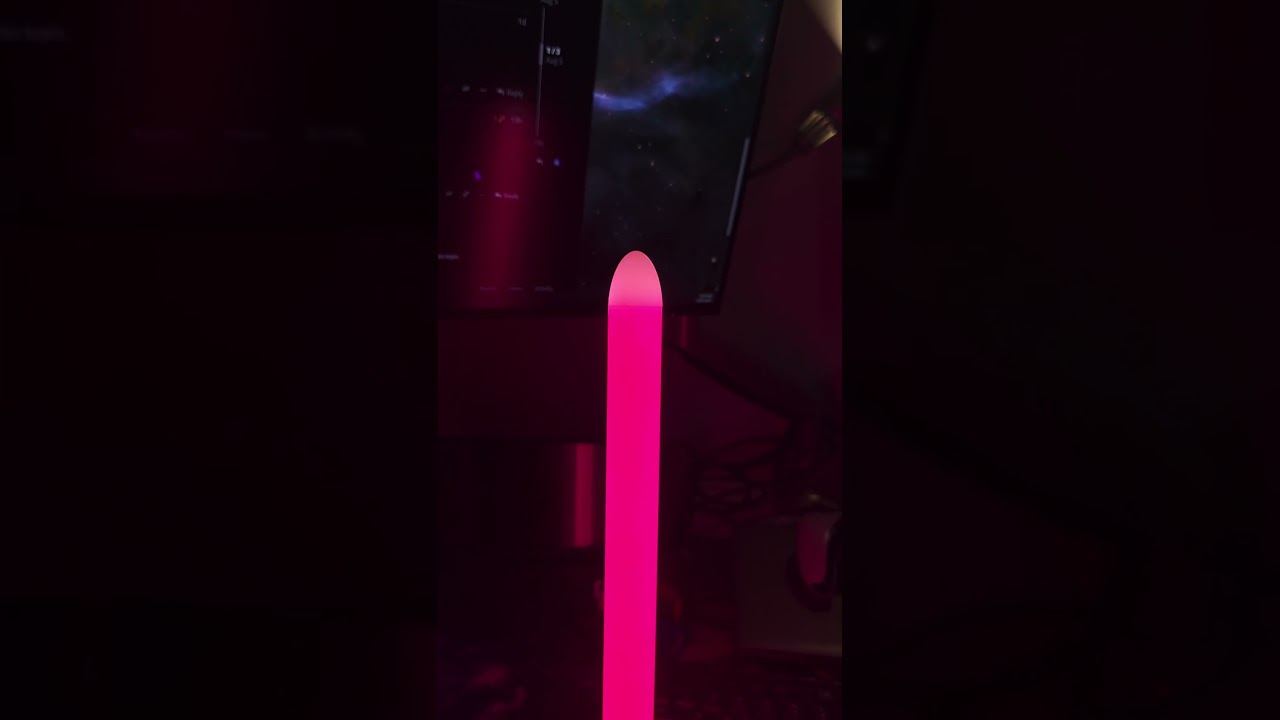

I used my bal venos font, edit blade length it read the current length, click to cancel and I exit out of the setting and the edit mode, twist off the saber and it is still running with the last pixel flashing.
I did a video but it’s not letting me upload. The file is mp4
Changing the preset resets the saber and the timeout works but when you turn the saber back on its still flashing the top pixel
Uploaded to youtube
