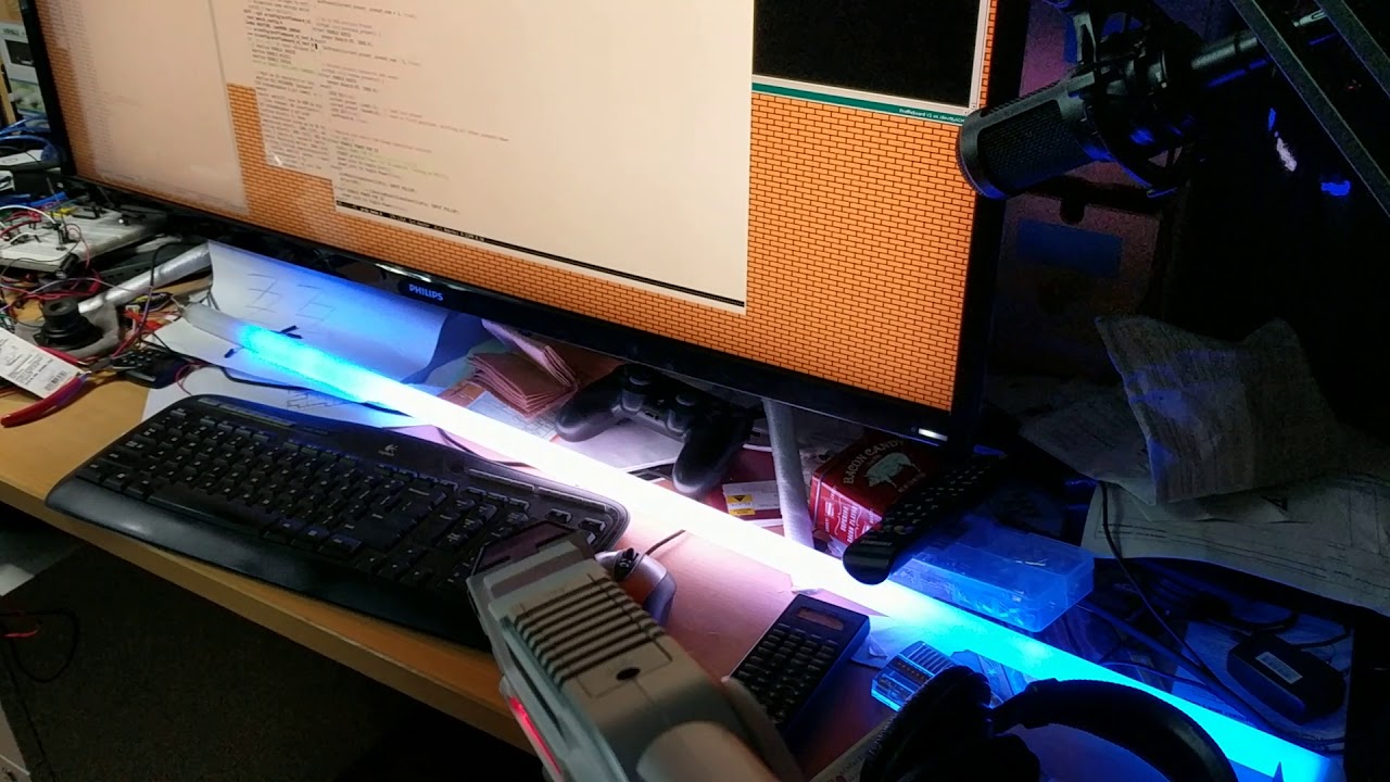

Well, I was mostly investigate these laser tag guns as a way to implement laser deflect for light sabers.
Well shit, that’s the coolest thing I’ve seen all day!
