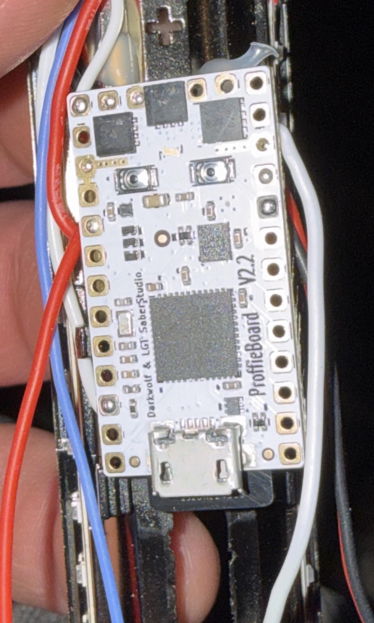

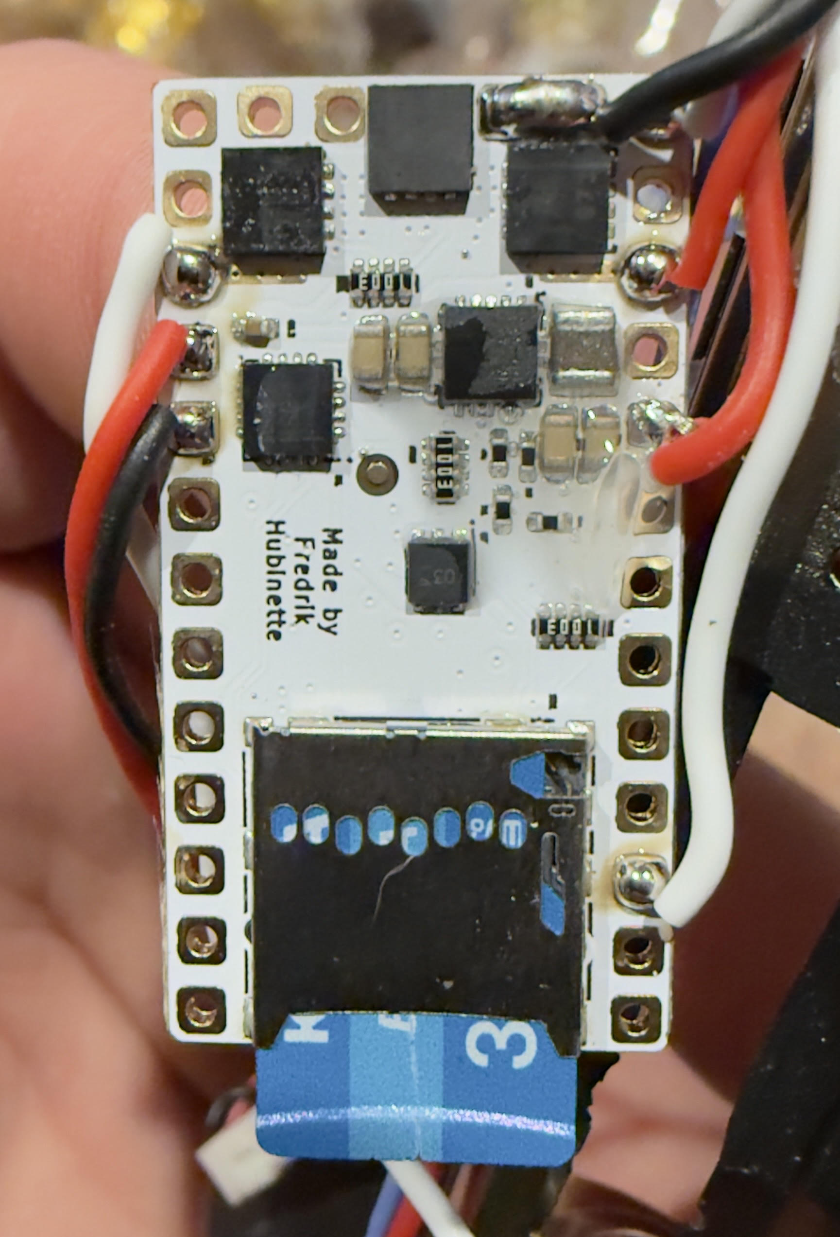

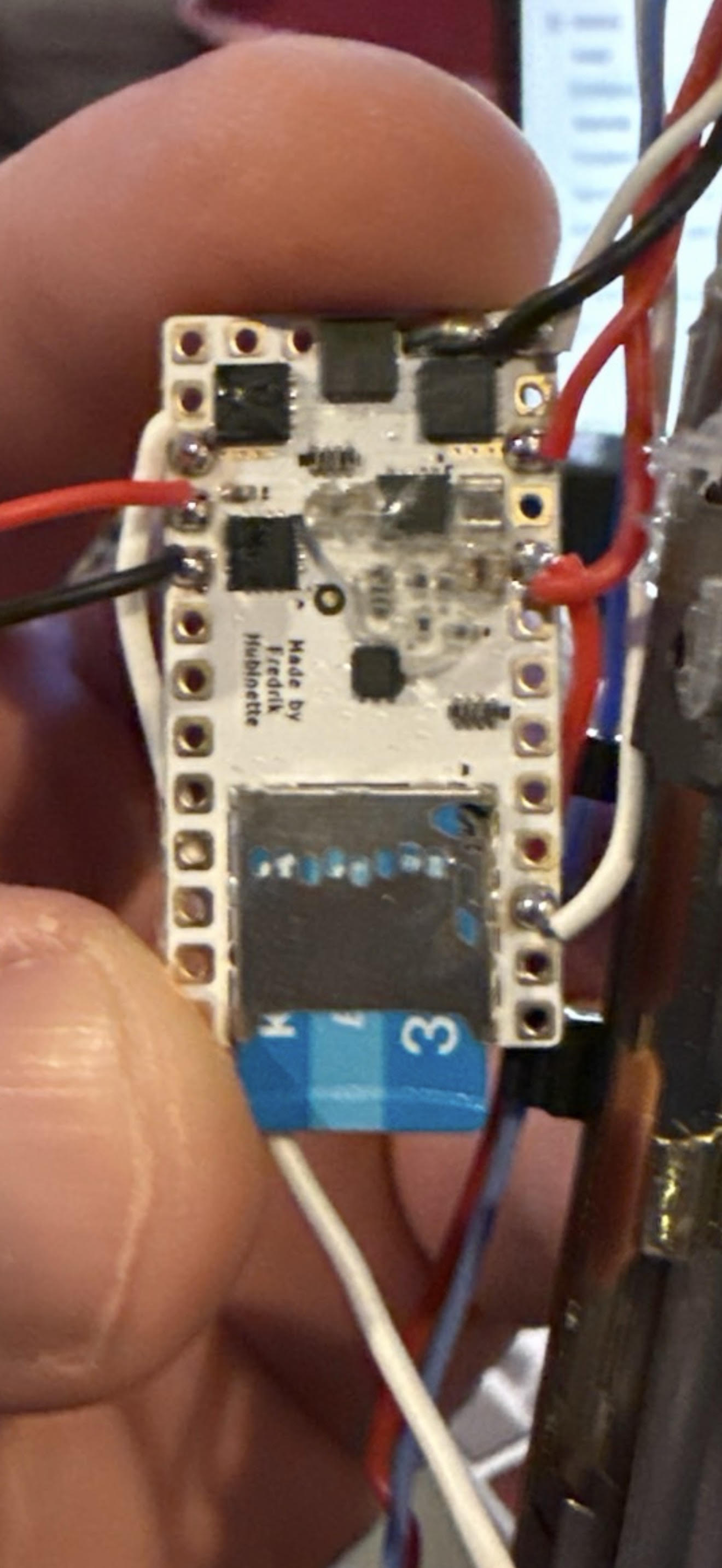

Thank you both for the reply. I am currently in talks with the retail supplier, so hopefully I will have an answer very soon. If it’s okay with you guys, I would like to expand my understanding here. I have attached some photos of the build, so any insight on how or what could be identified, I’m all ears.
Could you try and take the first picture again, but setting the focus on the board rather than your fingers. I would adjust the focus on “Made by Frederik …” text to get the board as sharp as possible.
The second picture looks good, and I can’t see anything wrong on it.
A sharper first picture might reveal something but don’t do anything to your board until you have explored & exhausted all your warranty options with the manufacturer/installer.

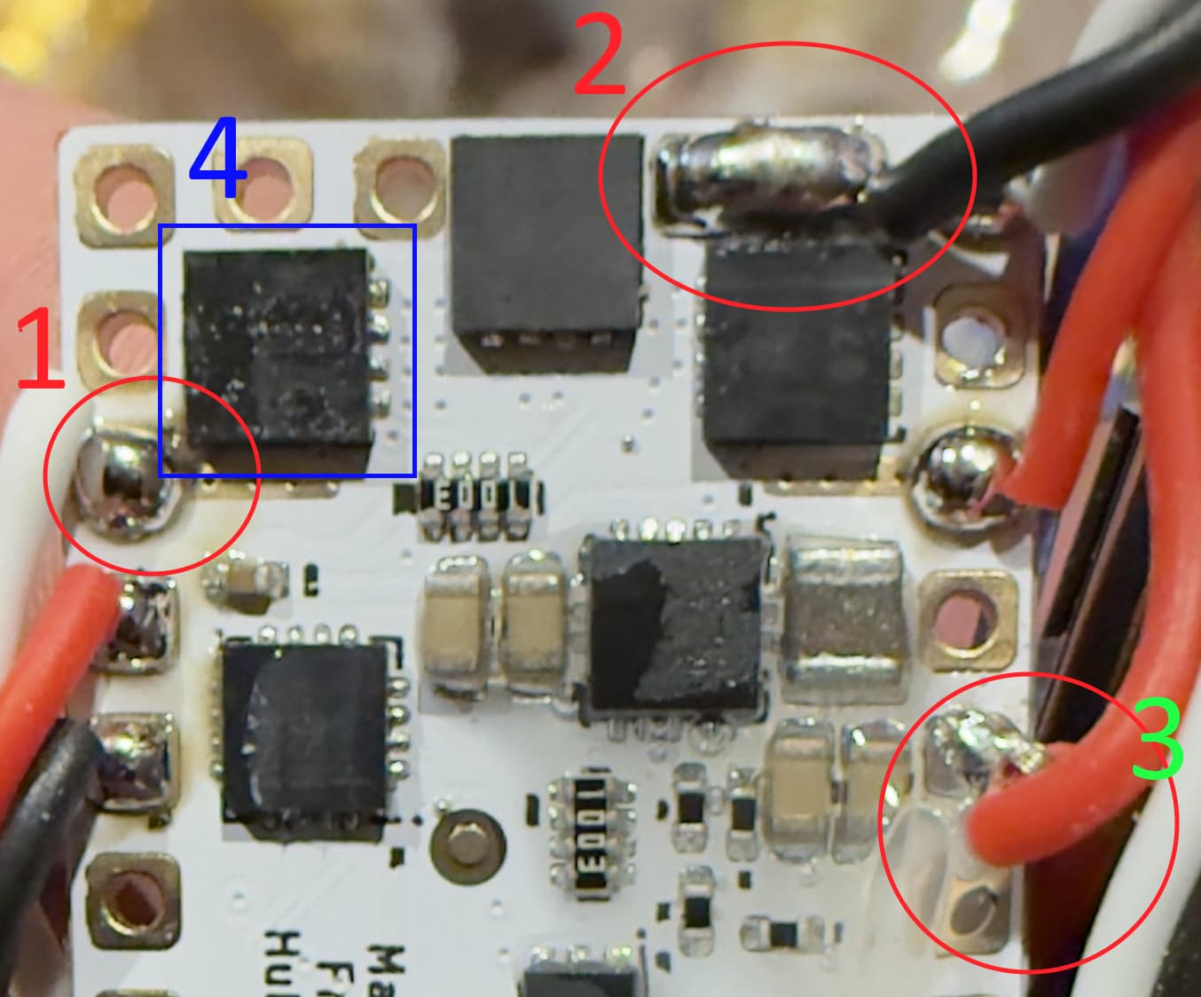

There are a few places that looks a bit weird:
  1. Is the solder touching the pin of the fet (4) ? I think it shouldn’t.
  2. Is the solder touching the pins of fet under it ?
  3. The wire looks damaged
Any news from your seller ? I hope you can get it fixed/replaced.
That fet is oriented in the other direction. It doesn’t look like there’s any potential for bridging.
This just looks like nasty flux to me, although it’s not a serious issue even if it is bridged, it would just mean LED6 is always powered. (which isn’t used here anyways)
At the very least the shielding, yeah. (It’s not good, but it’s probably not actually causing an issue here)
This thing’s a mess in general. Looks like something that would come out of a garage, not a factory… all the extra flux(?) and such. All these chinese boards seem to be of increasingly awful quality.
There is though, (most of) these fets have a small metal part on the side which can be shorted.
I agree that it looks a bit rough and the flux should be cleaned off at a minimum.
The diagnosis of a short btw 1 and 4 seems reasonable. If the retailer isn’t responsive, I’d remove the SD card and reflow that area. All of them could use it but that spot is where I’d start.
