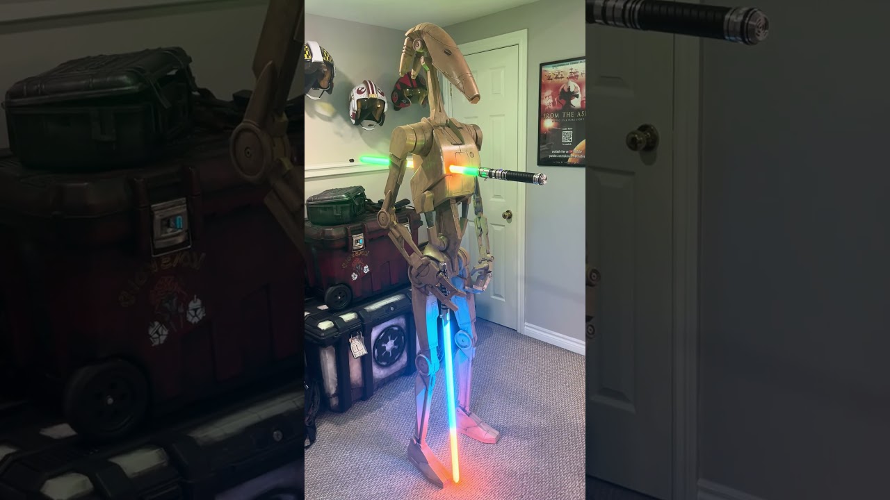

Meanwhile, here is a clip of both sabers fully armed and operational! The second droid is at a friend’s house, but it would be lying on its back on the floor.

Very cool, you’re welcome. Should be very popular, are you 501st or RL?
Very cool. Great idea and execution!
Hello! First, sorry I missed your message here - yes, I am 501st and RL. Stormtrooper & Plo Koon :slight_smile:
We debuted these babies at their first convention last month and they were a hit! Thanks so much for making it possible. I have a couple of takeaway notes to ask about.
