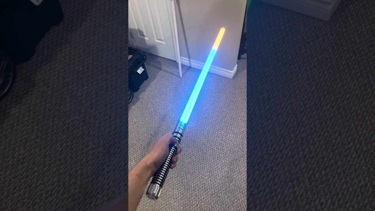

Update! Success with the sound effects. But it has revealed a new little quirk. It looks like the deactivation wipe is tied to the length of the “inNN” sound effect, so with the voice added, it slows down the animation quite a lot. I’ve attached a video to demonstrate - is there any way to make it so the blade wipes away quickly, and lets the sound effect continue after? I’ve attached a video to show what I mean.
Youtube link because I couldn’t seem to upload directly:
Also, less importantly, there is a notable audio cut between the “outNN” ignition sound and the hum/lock sfx starting up. That’s not really a big deal, but, ordinarily these sabers seem to fade in and out of sound effects quite seamlessly. Can you think of anything I can do to smoothen that out?

With that in mind, I think we might be all done! I’ll let you know if I encounter any other oddities. Thank you so much for you help. I will post a video to show the results!
