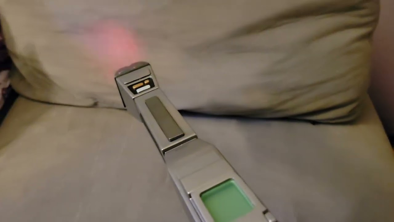

yes, I’m wanting to use a shtok v3 in the emitter of a phaser rifle. I’ve got the model fitted for electronics, just need to figure out the code. I will then make a font for it.
turns out a phaser font is really easy, lol. Ive got the animations i need, it’s just I click on, then click off for now. Just using standard fett263 buttons for now.

This is like a quick little vid, i still need to do the rest of the sounds for menus and stuff.
I am making a flip up lcd targetring display for this using a modified version of my tricorder screens
Cant wait to get a hold of a 3.7 once they come out to get at that 2nd spi, want to see if it can handle neopixel and full video simultaneously.
I was wondering when you were gonna post the follow-up video.
Is the green top screen going to be done up too with animations or interactive like on the Tricorder?
Awesome work my friend!
