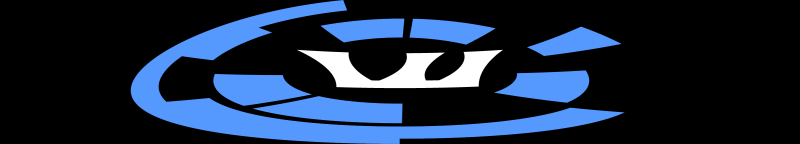

It just worked. This is with my changes to the Makefile only to make the height as a variable. The full color works because it is only 2 colors I guess and the white is visible (picture above somewhere).
I had to update the pov.h file to the height as mentioned before, to stop it from freezing, but other than that I did not think about checking windshieldwiper.cc.
There was the 144 hard coded at the bottom. This is where I put into pov_height = 72 and used it where 144 was before. But only in that file.
My guess is that something goes wrong when during one of the steps it goes out if bounds of the 72.
Well we don’t have to do any of that apparently, and it turns out after ALL that overnight work (educational as it may have been)
NOTHING except the Makefile needs to change for it to scale width AND height.
All that it needs is a HEIGHT variable and it just works .
