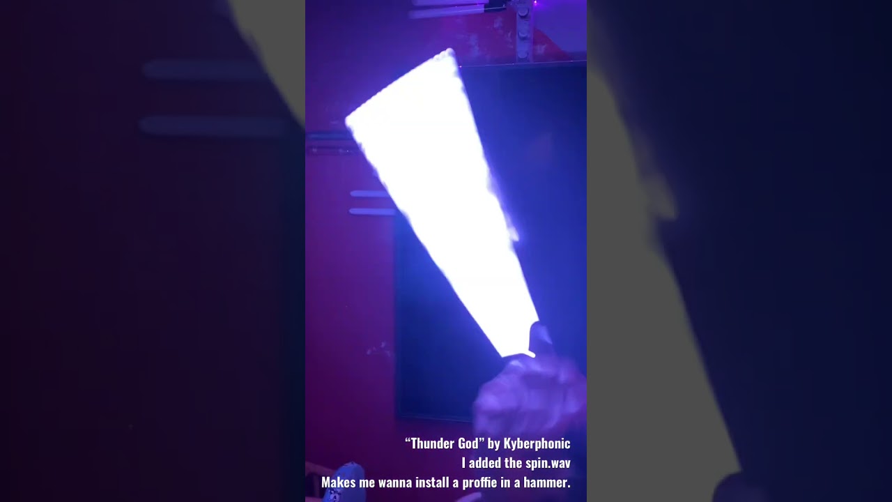

Before I found what’s been previously discussed on the subject (Rebel Armory) and before I looked at a few fontmakers’ spin.wavs in Audacity, I just assumed spins acted like smoothswing pairs/hums, so that’s how I treated them—like a short, looping sound. I didn’t realize the prevailing idea was more akin to a slash sound or accent swings, so this is the result of my tinkering prior to that. Having said that, I think it came out pretty decent. I’ve been working on this font and a spin for Jesse’s Thunder God (Thor). After tweaking and playing around with the length of the sound file, this (0.6–0.65 sec.) seems like a decent compromise between spin start/stop times and length of the wav file. My one tiny complaint is that maybe the spin sound starts too early because when I’m playing around with my saber, I do lots of 360s apparently, which trigger the swing.wav. Minor in the extreme, though, like I said, because once you go into a “flow” the spin takes over as long as you can sustain it, and it’s pretty damn fun.

Where do I change the values? The config.ini file? I will def keep tweaking. It could be perfect, with some work, I think. Thor’s hammer twirl is the bomb.
Yes. The font’s config.ini
