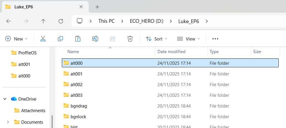

My current font folders dont have the alt subfolders, do I just need to create them?
Yes. Watch the videos and follow the instructions. :+1:
Yes, the Recommended videos at top of the library for Phases and Alt Fonts will walk you through.
Thanks, I think ive gotten my head around most of it, one thing that I cant seem to find the answer to, does the number on the altNNN folder name relate to the phase number? So I would need to create a numbered folder for each phase within the style?
If you’re using my library, then Yes. The top style information section provided when you generate a style from the library includes the Phase and Alt information. Phase 0 uses alt000, Phase 1 uses alt001, etc. If you are missing an altNNN folder that the style code expects then the phase won’t change, so always refer to the style information the library provides.

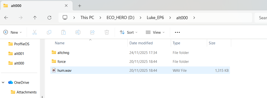

Either way i have tried all naming conventions in all instructions I can find still getting error, this is my folder structure, all alt folders are identical

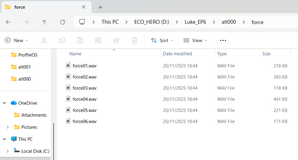

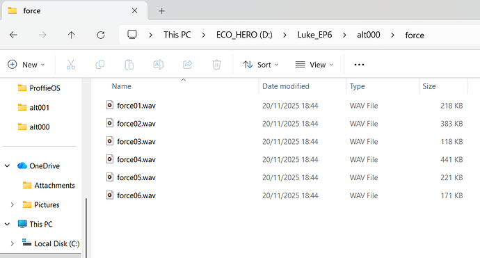

I have also tried renaming the force.wavs as 01.wav, 02.wav etc

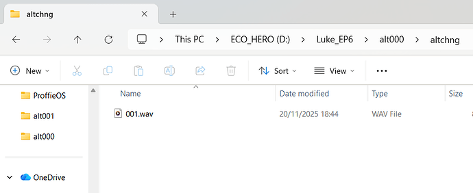

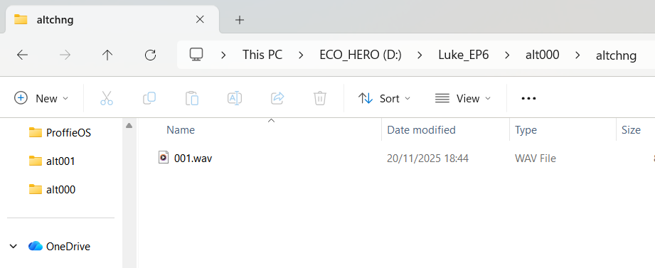

If I just create
alt000\altchng\001.wav
alt001\altchng\001.wav
alt002\altchng\001.wav
alt003\altchng\001.wav
Then I dont get an error but when I try special ability it just plays the wavs in the main font force directory and the colour doesnt change
