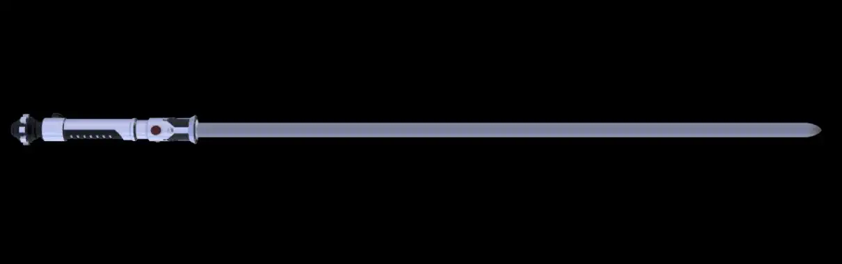

So the lesson to me was that a style building fine in the ProffieOS Style Builder or even on actual hardware running OS8, doesn’t mean it will compile on other ProffieOS versions. Oh, and to round out this post, here’s a visual of the style.
WavingFlagUSA
