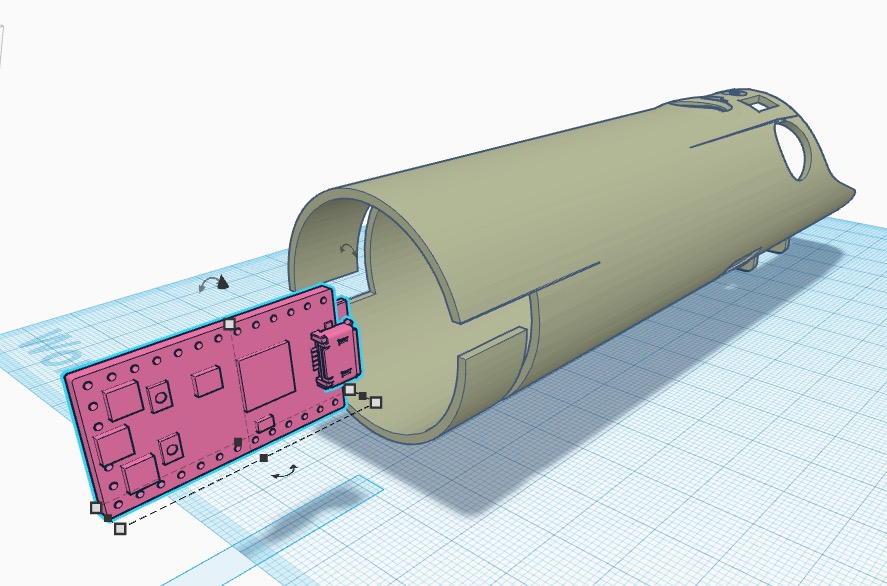

What would this need for orientation define?
I get the USB TOWARD BLADE, but also rotated 90 (or maybe -90)
Can 2 defines be used at the same time?
#define ORIENTATION ORIENTATION_USB_TOWARDS_BLADE
and
#define ORIENTATION_ROTATION 90,0,0
Not clear on how Z axis works here.
If y is tilting blade up and down,
x should be like a barrel roll…
