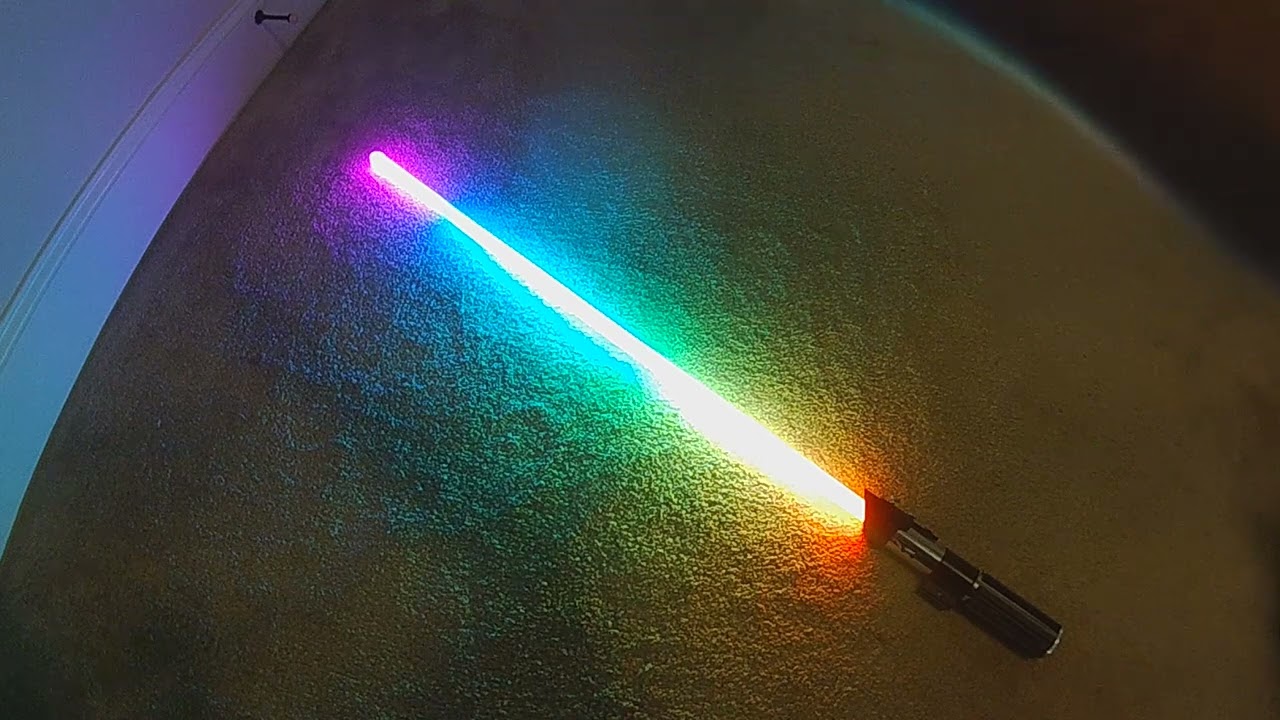

Hi!
This one works fine.
These are ones I could never get to work

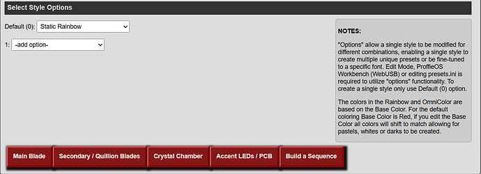

This one works but not the others
OK, yeah those are old. I tried and all but the OmniColor seem to work for me.
I probably won’t get time to look until the weekend but you can recreate OmniColor for OS7/8 by going to the Static Blade, then on Enhancements screen set the “Color Type” to “OmniColor (Rotating)” and it will make an updated version that you can actually customize the speed on.
