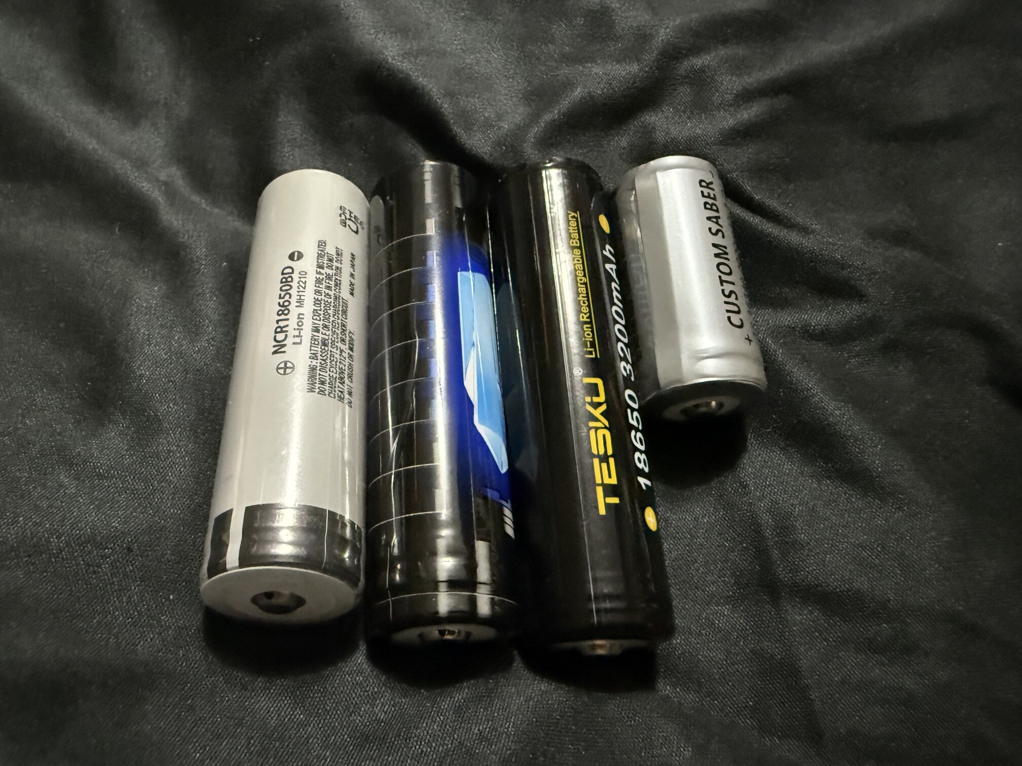

Seems like 89sabers uses an ncr18650bd on their proffie3.9 chassis
Its a few mm shorter than you standard 18650(button top)
I cant seem to find a reliable place to get extras of em
Any recommendations ?

They are just unprotected and therefore shorter.
Just search for unprotected 18650. They should fit. Although, I have to mention that unprotected batteries aren’t recommended. But protected do not fit, so what do you do, eh?
Panasonic NCR18650BD is an unprotected battery by default, which is generally not recommended.
Please use protected batteries.
You coupd get a protected 18500 and devise a spacer.
How can you tell if its “protected”?
Well anything longer it will not fit the chassis
The product description will say.
This are the different batteries i e seen from sabers i e ordered
Which ones safe which one is not?
The grey on the left is the 18650BD
As you can see its a tad shorter
They aren’t unsafe per se… Just unprotected from over current discharge draw, which can occur in saber blades with lots of leds.
However, back to your question - I would think the batteries that are a bit longer (and are still 18650) are protected, but have a new shrink wrap applied.
It’s actually damage from discharging the battery too much that is the biggest danger.
You do that too much and suddenly your battery starts to swell, and that point it’s a fire hazard…

FYI, this is what came in the 89Sabers saber that I purchased and what their customer support pointed me to when I complained that they put an unprotected button-top in their sabers. Sigh.

If a chassis is made for an unprotected battery, you have to use an unprotected battery. Those battery holders will be substantially shorter. ![]()
You won’t find a protected battery in the unprotected form factor (if you do it’s super niche), and if you manage to smash a protected cell in there, you’re probably risking breaking the chassis, contacts, battery, or all of the above.
Allegedly they put protection circuitry in the saber separately.
If you don’t like the idea of using an unprotected battery your options are to not use the saber or reinstall it
Indeed, they made the battery compartment tight enough that there’s no way to “accidentally” shove a protected button-top 18650 in there.
FWIW, when I complained, Customer Support didn’t mention anything about having protection circuitry in there separately.
