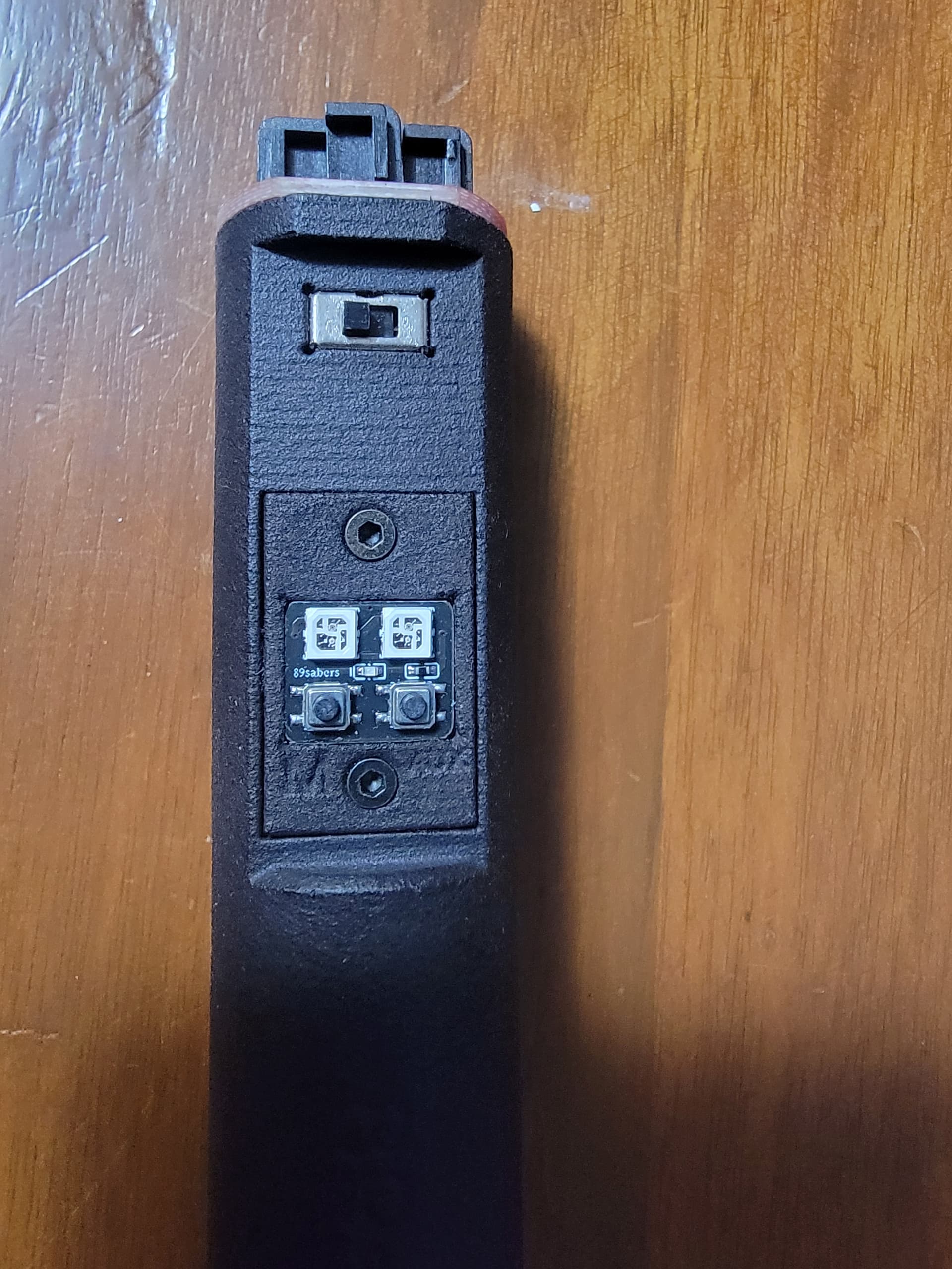

The saber is an 89sabers Maul Ventress. It has a crystal under the emitter and another in the pommel. I wanted to program these to stay on while the blade is off but after all my testing i have discovered that while there is a second “blade” in the config file, all that it is wired to are two lights on the chassis that cannot even be seen through the hilt.

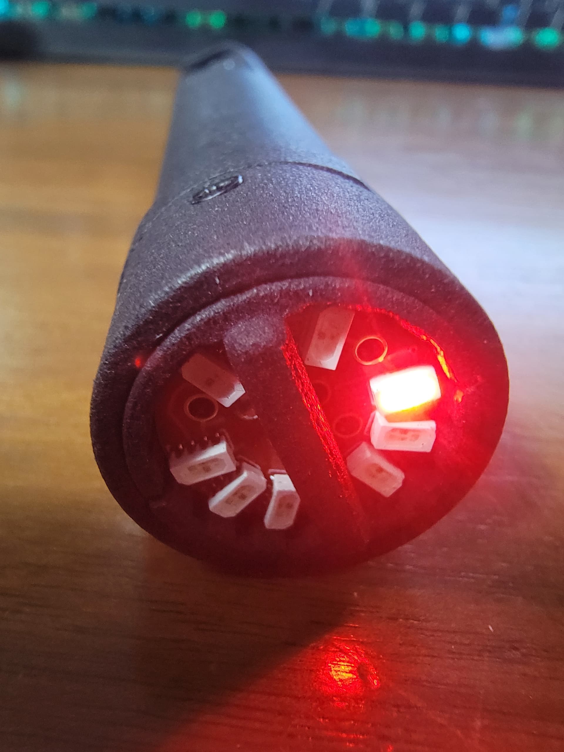

I edited the BladeConfig so that the “second blade” would use the same pins as the primary(probably a bad idea) with a length of one and the result is that i can light up the emitter crystal,
but only 1/9 of the pommel crystal.

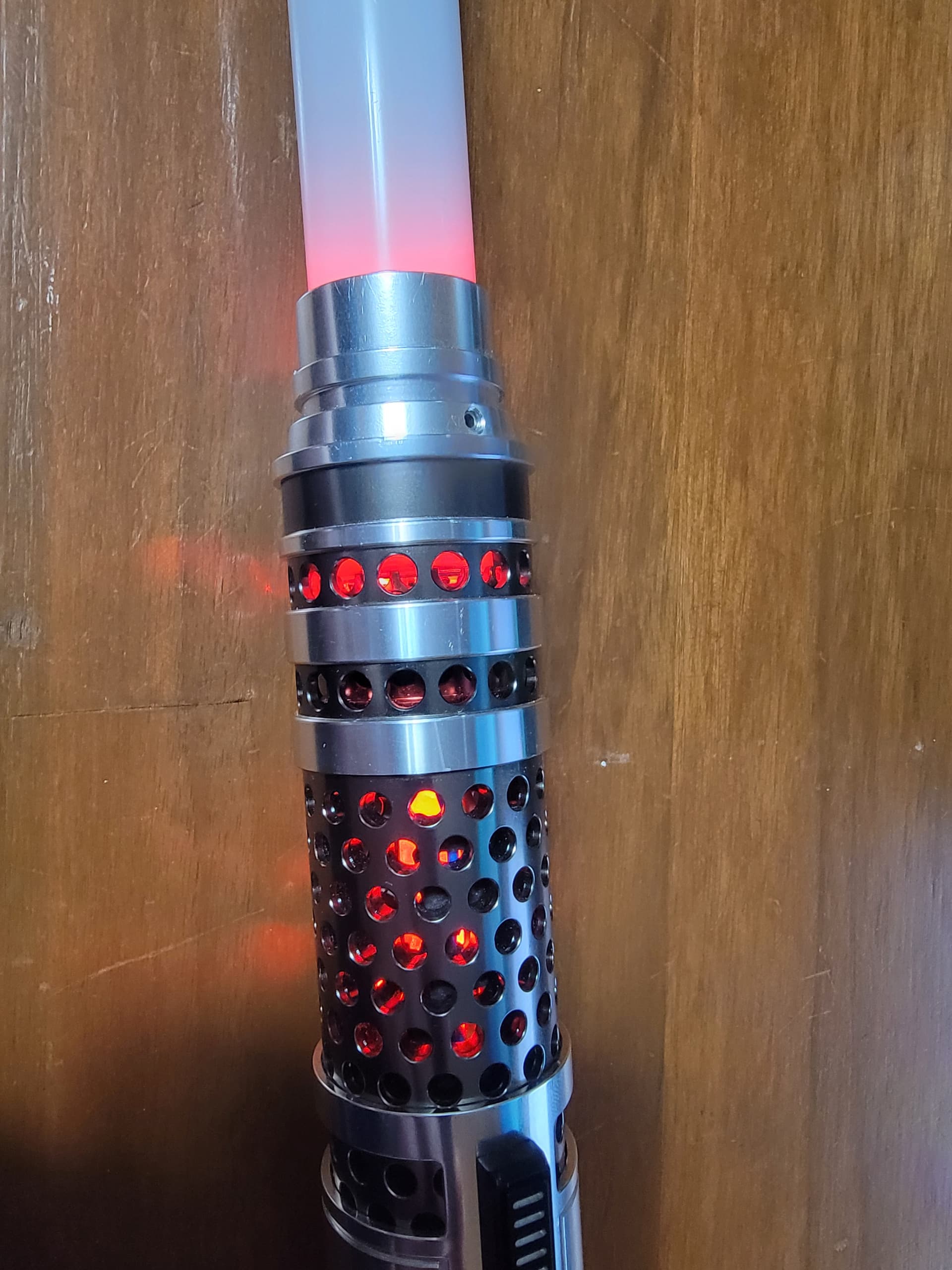

Also the first pixel in my blade stays on.

However it would probably be farly simple to rewire the pommel LEDs to their own data line as they wouldn’t need to go through the multi-pin connector.
