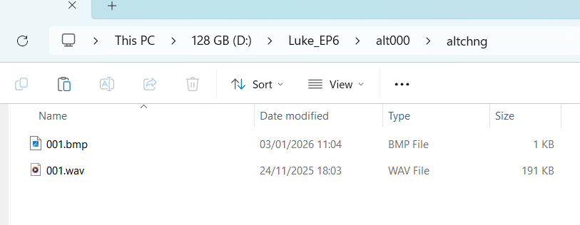

Didnt seem to, this is my folder structure - I just get the battery level and then the preset names when changing presets

I think you want the bmp to be for font or on not altchng. It needs to be a supported bmp.
Put it in altNNN/font or altNNN/on folders and remove from root obviously.

So copy the root font files and folders and make a copy in each altnnn folder?
No, font.bmp and/or on.bmp, make copies of those files in each altNNN. It needs to be a supported bmp, see link in above reply
no joy have tried naming font, on, and boot
displays if i put it as boot.bmp in the root so bmp is ok
no biggie , I just wondered if possible
