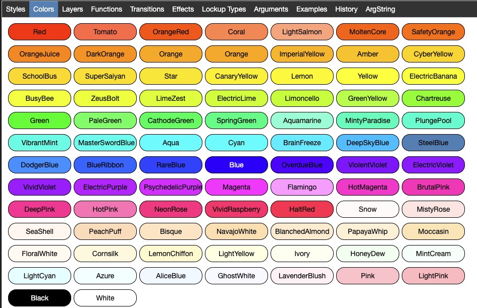

For a while now, I’ve been meaning to add some more builtin colors to ProffieOS. However, first, I wanted to inventory the colors we have so that we can add new colors in areas of the color wheel that doesn’t already have a bunch. I finally got around to doing the first step, and here is the result:
As we can all see, there are large areas which have no colors, which seems like a problem, like for instance to the left of the chart.
This chart is in linear HSV space, with V fixed to 1.0. That means that all colors on this chart are at their maximum brightness, it is not possible to make the color brighter without also changing it’s hue or saturation.
Anyways, I could use some help with figuring out names for these new colors…

The chart now looks like:

Found some more color names:
These are excellent. I am very picky about purple and there’s some great choices in that range.
Dialing in colors with zoom is a great thing, but having more named choices would be great :slight_smile:

I added them. Style Editor just hasn’t been updated officially yet.
You can play here
