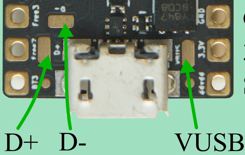

Micro USB port wondering
All you’d need to do is wire them up to these pads, with the ground wire connected to a GND pad. The 3.9 boards have a 450mah battery charging circuit integrated into them, but iirc no protection circuit, so make sure you use a protected battery!
