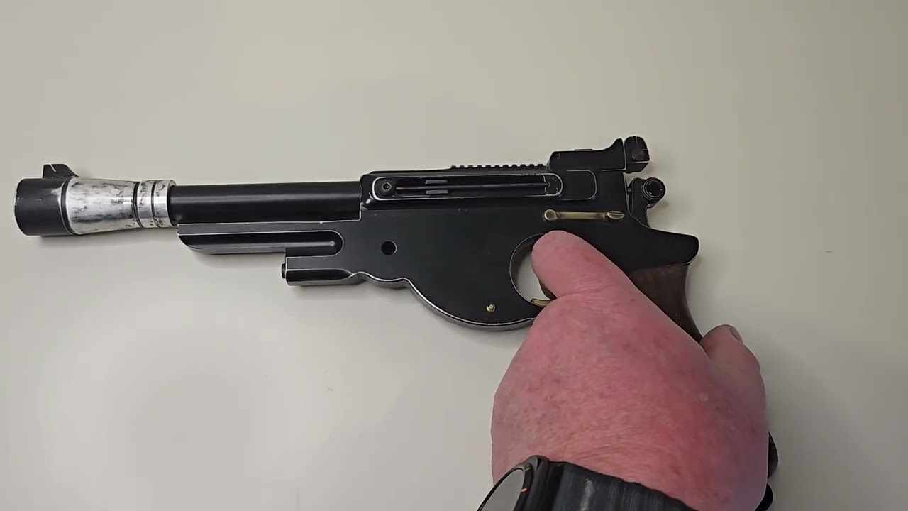

Here is my blasterfactory aluminum Mando Blaster.

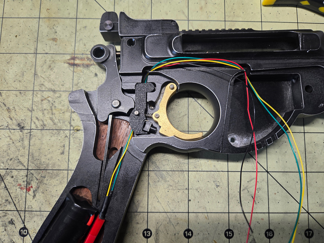

It has a proffie v2.2 board, 13350 battery, 20mm speaker, single accent pixel and large 20 pixel ring for muzzle flash.

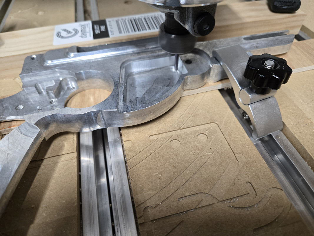

The battery is in the grip, I used a cnc to open up the frame and make recesses in each grip panel. Its pretty tight. I also used a cnc to make the wire paths and opening for the proffie chassis.
The chassis is 3d printed and everything barely fits, but it worked!
The blaster is painted flat black, and I flame blued anything steel.
The it sounds pretty good imo, Not very basey, but that’s to be expected. I could not fit much in the box in the frame. It sounds better with the side panel on rather than off.

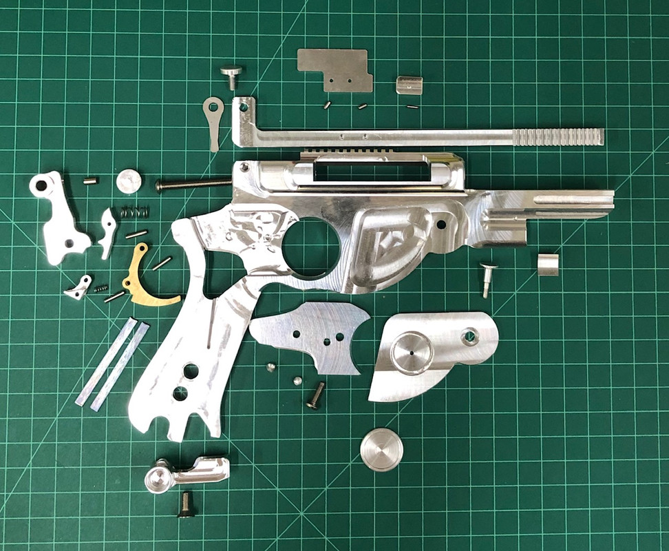

What did you make it out of, like what did it look like before you started modifying it.
Thanks, I am aware about the issues with metal props, but I do not plan on taking it on any trips, lol.
The kit starts out like this:

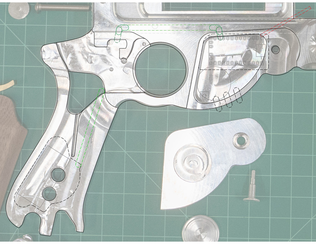

I then scaled it into my cad software
Here you can see the planned cuts. The green and black boundaries.
Here it is doing its thing
Here is a shot of the battery compartment, and you can see the 3d printed wire chase/switch holder I designed as well.
