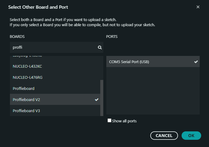

Yesterday I was fiddling around with your Instructions page, and finally got my saber connected and Arduino even shows the COM Port, etc.
