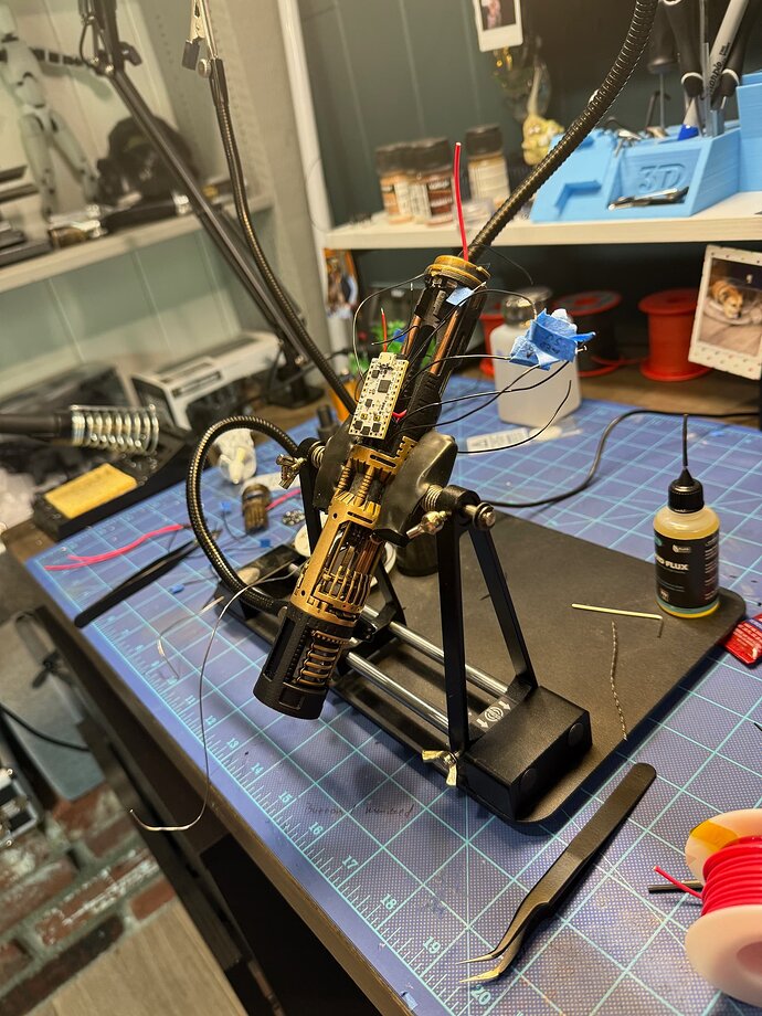

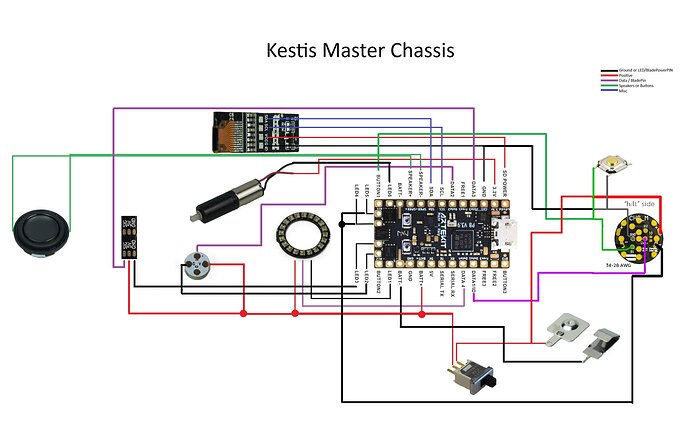

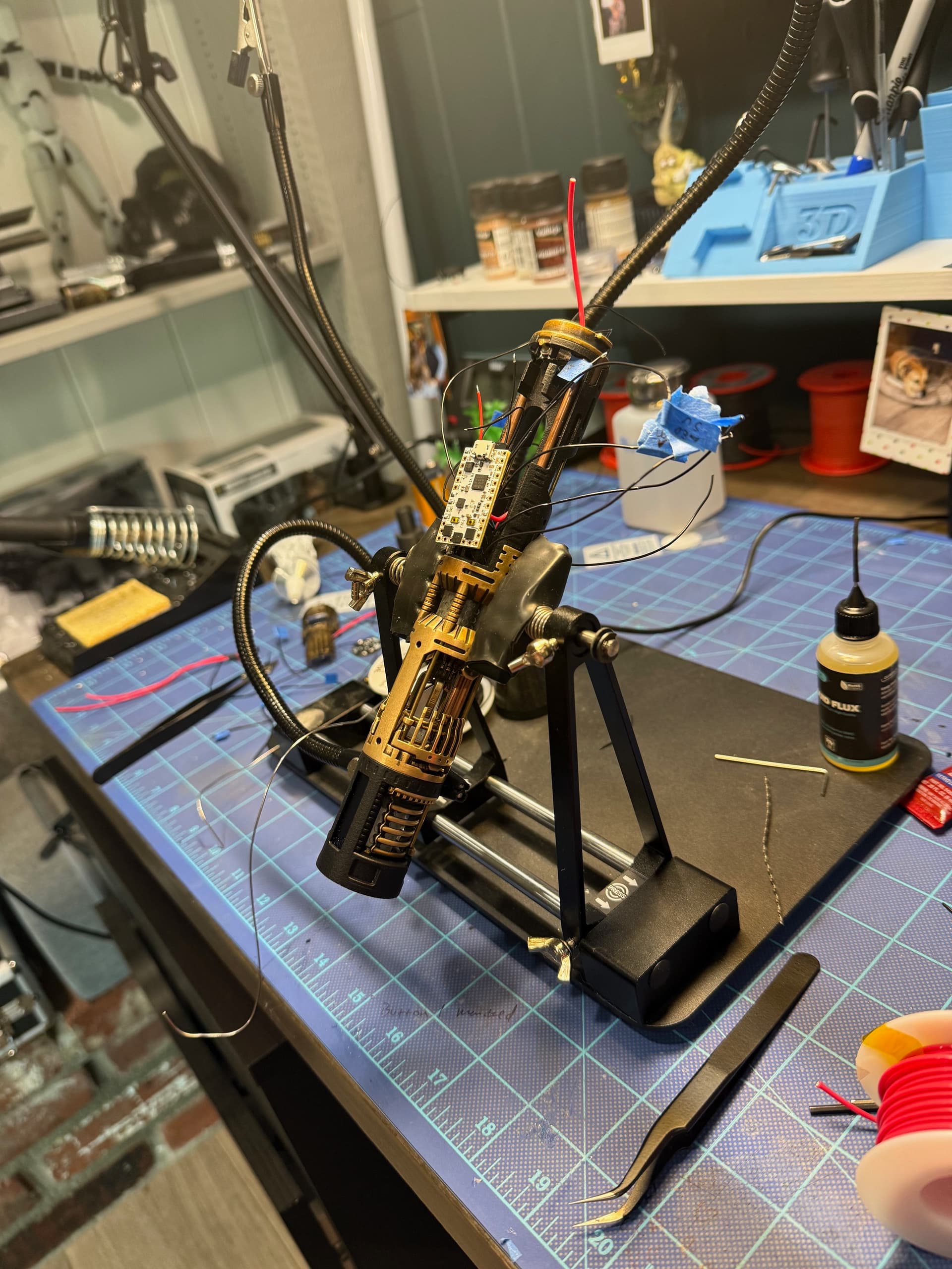

First post on here but thought I would share my KR Kestis Master Chassis build from Goth3d.

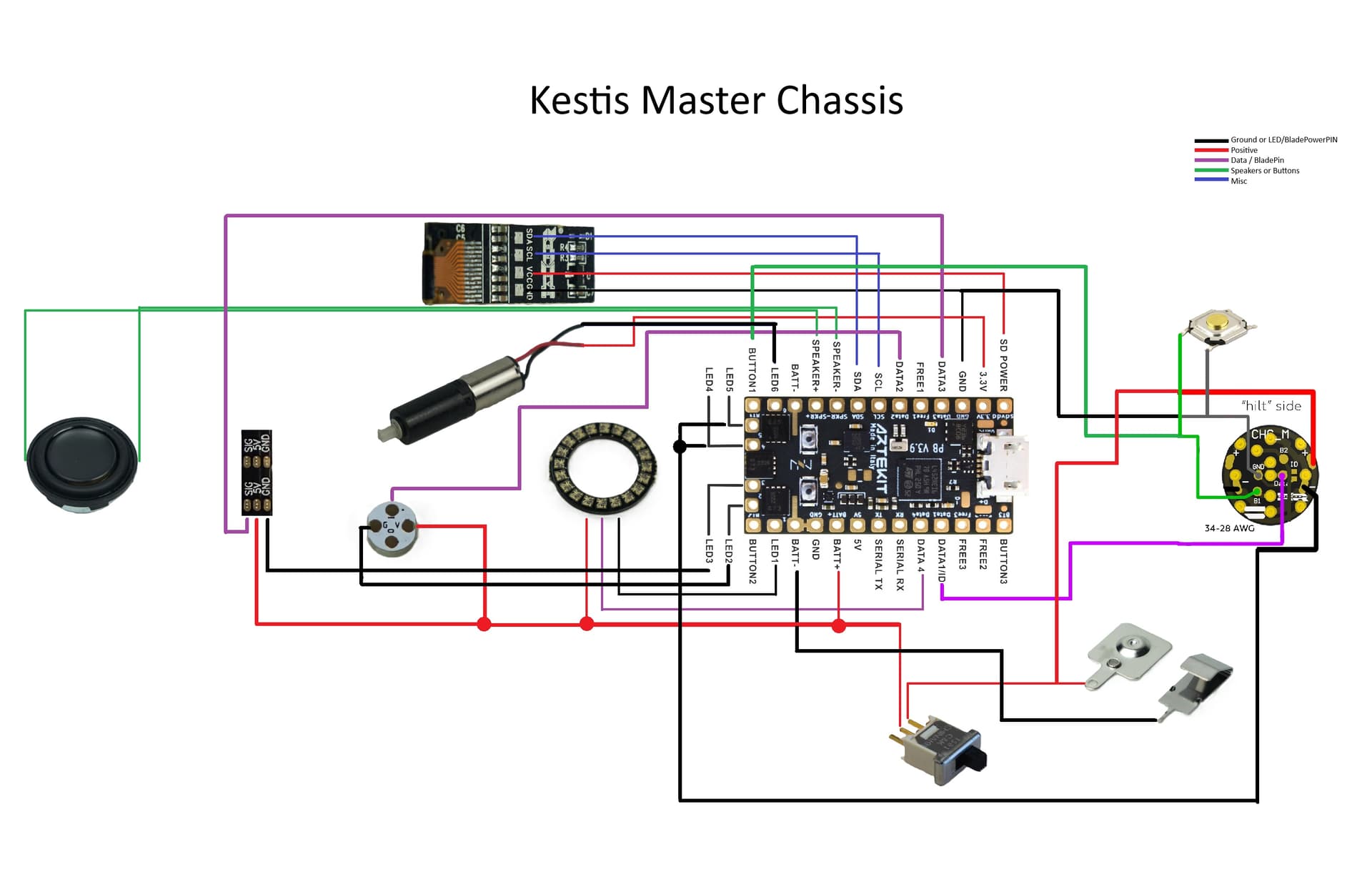

Planning this build out is a must with any complex master chassis build but well worth it. Working on the config currently and will test out once the chassis is completed. Here are a few pictures as well as my board layout.

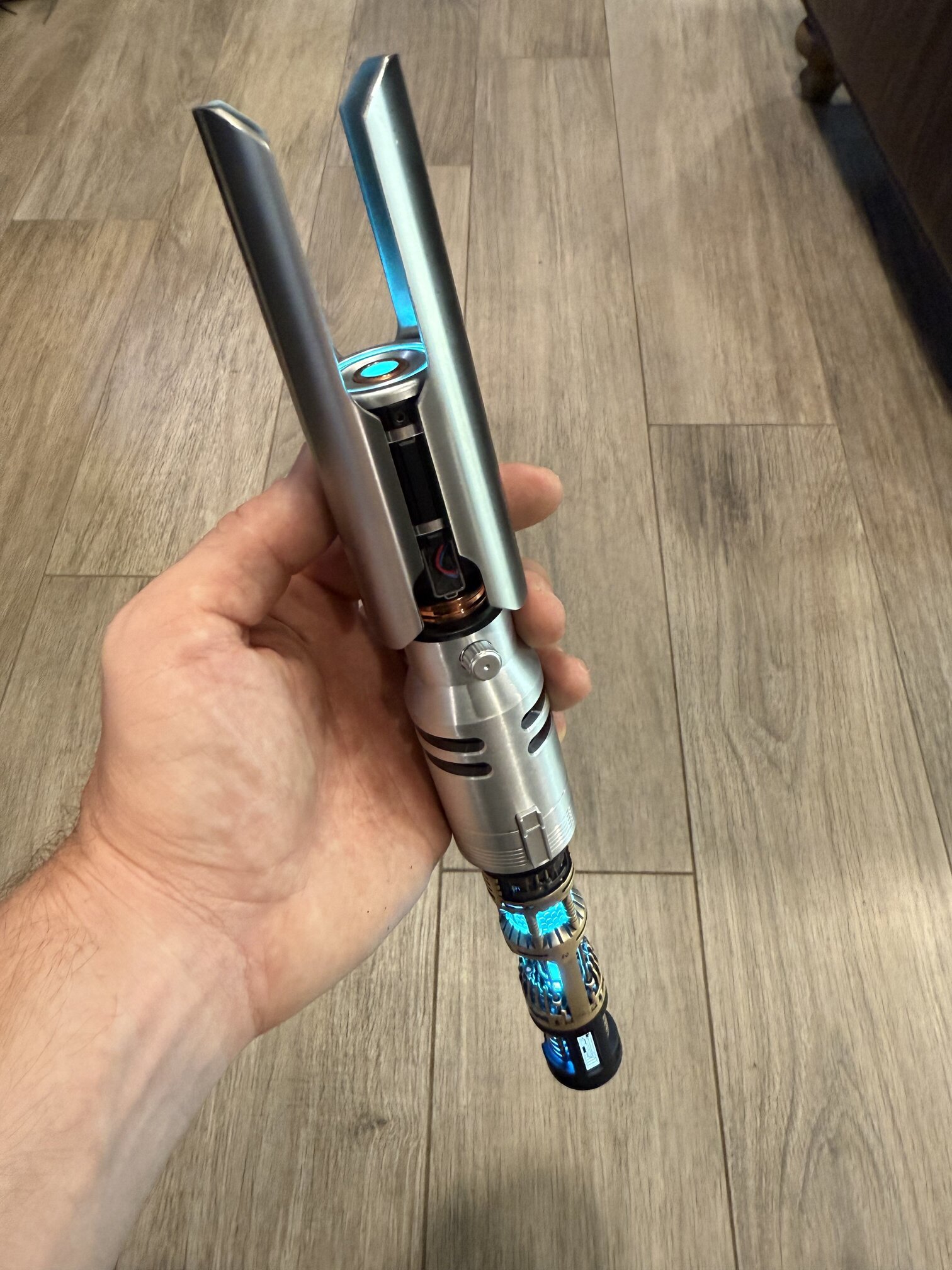

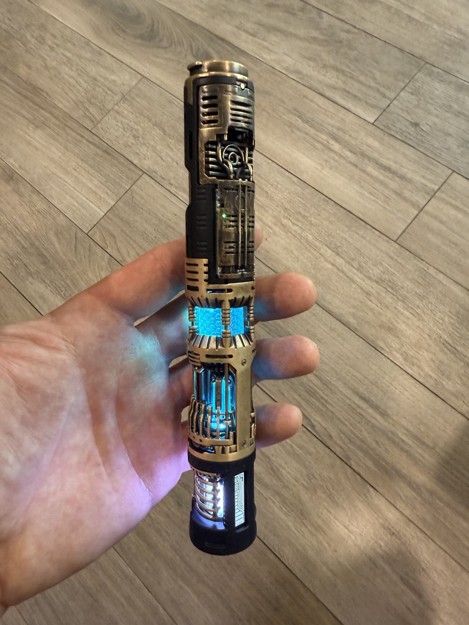

Finished the build up today. Thanks to Rick at goth3d! Need to get a resistor for the blade Id function. Should be in today and this will technically be done. Maybe some tweaks to the config and ready to rock.
