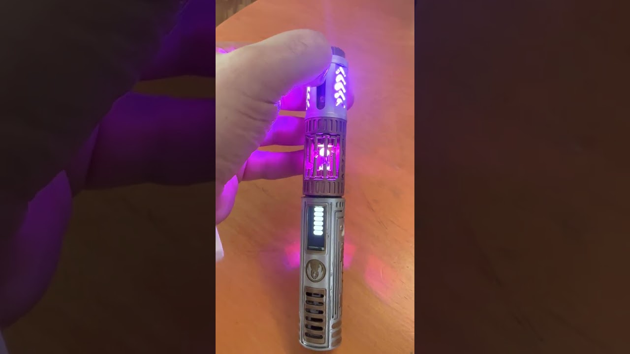

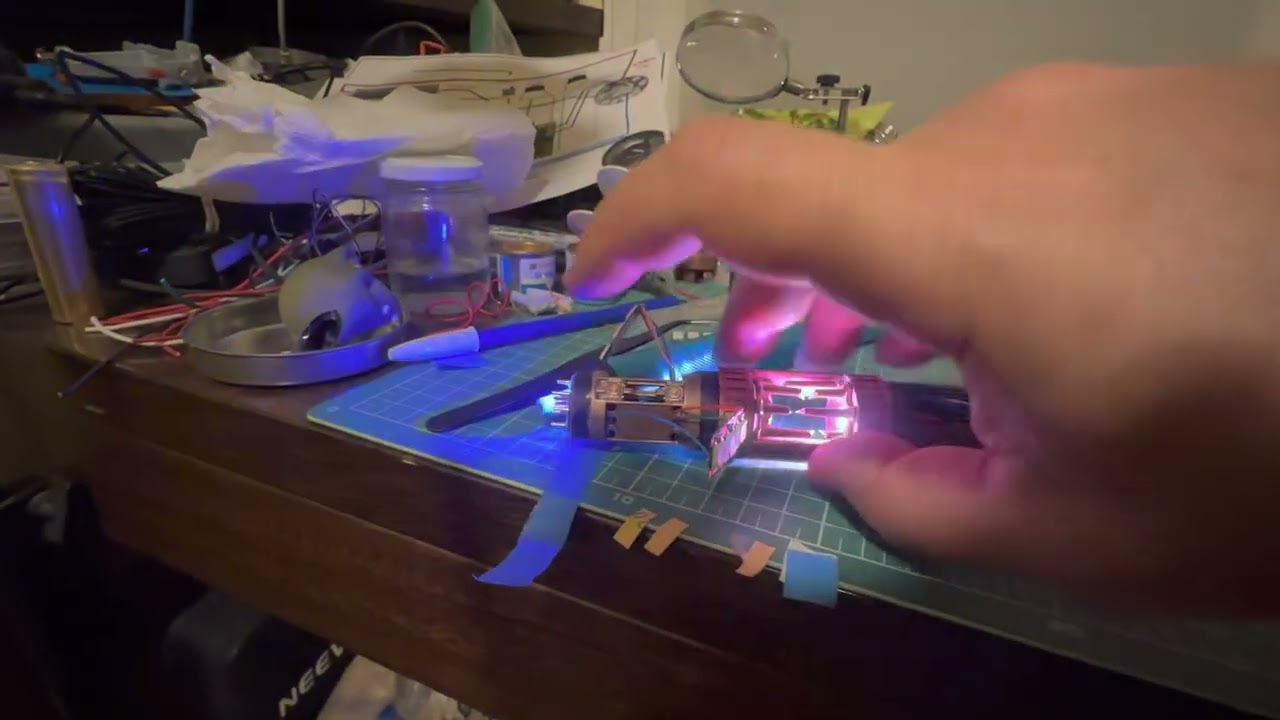

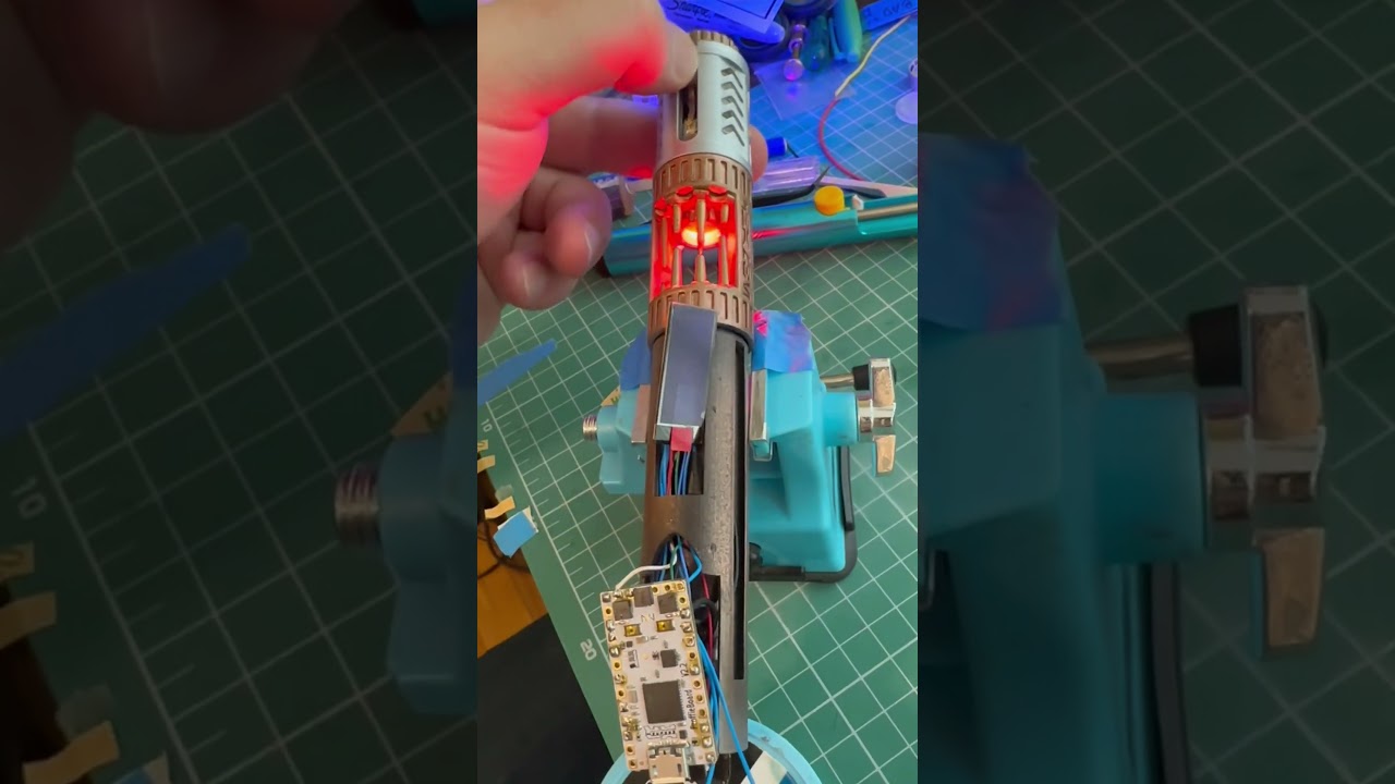

For those interested in the actual config, I’m attaching it to this post. It is a heavily commented OS 7.3 using almost all the available features. It include a CONFIG_STYLES section, the styles are called with parameters, I use SubBlade and SubBladeWithStride, multiple samples for Blade ID, have Blade Presents, two data lines, OLED, Fett263 prop, with styles made in his generator, and have a ridiculous amount of Blade IDs for things like tri-cree adapter for NPXL, charging through NPXL, illuminated pladeplugs and more.
##### General Specs #####
Hilt: Korban Revan Light V2
Chassis: Baldusi Custom v5
Board: Proffieboard v2.2
ProffieOS Version: 7.3
Soundfont Collection: 2023-03
-Momentary Switches: 2
-Battery: 18650 (+USB-C battery charging)
-Speaker: KR Sabers 22mm V2 3W
-Hilt NPXL Connector: Shtok NPLX V3 Illuminated Connector (V4 Config)
-Crystal Chamber (SubBlade)
-Accents (SubBlade x3)
-BladeID: 33k resistor (0603 SMD)
-Blade Present Pin (Data3)
-OLED 128 x 32 pixel SSD1306
//NO FSC BT909 Blutooth Module
##### Hardware Config #####
-PowerButton: Button1 (21)
-AuxButton: Button2 (23)
-NeoPixelBlade01: LED2+LED3 (Shared), Data1
-NeoPixelConnector: 16px, LED2+LED3 (Shared), Data2 (470 Ohm resistor)
-Crystal Chamber (2px SubBlade)
-Accents (SubBlade 3 px X3)
-BladeID Resistor: 33k
-BladePresent: Data3
-Save State
##### Install Intent #####
This is a dedicated Korbanth Revan Light V2 saber install. As such, it should have blue,
green and the iconic violet settings. Blue and Green should share the soundfont, while the
violent should use the dark or fallen soundfont. I bought JuanSith fonts on this saber and
Lord Blako and Kyberphics Butcher for the Korbanth Revan Dark V2, so they don't have the
same sound when paired together.
@@@ REMEMBER @@@: YOU SHOULD PAY FOR EACH SOUNDFONT THAT YOU INSTALL: MULTIPLE HILTS MEANS
BUYING IT MULTIPLE TIMES!
////// Hardware Defines //////
#define NUM_BLADES 7 //(1 x Blade + 2 x illuminated NPXL PCB + 1 x Crystal Chamber + 3 Accents)
