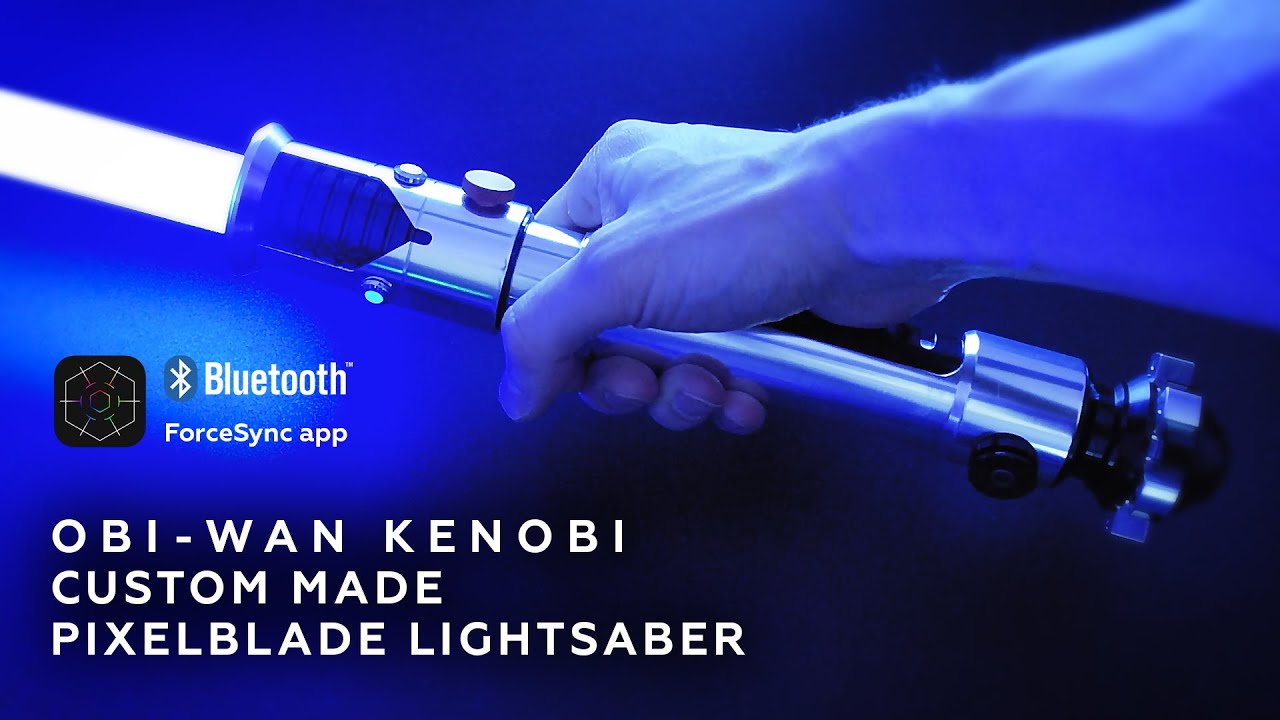

Korbanth OWK1 install
Features:
• Korbanth OWK1 old series hilt
• custom designed 3D-printed chassis system with metal tubes and sound board hatch
• 1 button + motion control
• 28mm bass speaker in the removable pommel
• in-hilt battery charging and SD card Data access through USB-C port
• charging status Red/Green LED indicator
• Kill Switch
• Pixelblade configuration with SCW NPXL connector
• removable Protected 18650 3.7V 3000-3500mAh battery
• Proffieboard v2.2 sound board
• FSC-BT909 bluetooth remote control module
• OLED display
• total weight of the saber without blade: 490 g
• duel worthy
Video:
